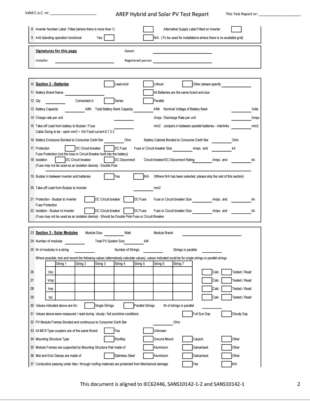

A very important point. There is absolutely zero information on the DC aspect. That is why it good to use the AREP or PV Green card CoC document which is much more comprehensive & covers the DC side in good detail. I use it because if there is a come back or a claim that the equipment installed wasn't to spec or an insurance claim me as an installer are fully covered.

out of interest, does the PV Green card CoC have the below letter head?

It honestly doesn't need to because it does not replace the CoC as we know it neither is it pretending to. However, it's got all the nity grity of the DC side of the installation & Breaker size, fuse sizes, string length, panel size, Wiring diagram & actually makes what should be a compete CoC for a solar installation. The solar installation CoC that can't answer how many panels are on the roof & what layout falls very short of what it should be currently. We not there yet in terms of cleaning up this industry but this document does go a very long way into bridging the gap. I am also not trying to affiliate to either of these two Bodies, I'm merely stating what good work has been done & formalization of these testing forms & documents covers the juicy important details required. I will post a pic of the document. If anything this should provide piece of mind for a person who gets such an installation done.
By the way this is not some new CoC unofficial document it's a guideline that I really welcome & all these documents formally in my mind constitute a proper inspection of work done & will make any omissions & deviations stand out.
When one looks at this document there is nothing left to the imagination in terms of what type of installation it was. What inverter? What power plant size. What AC & DC wire size used. What isolation & MCB sizes used....
