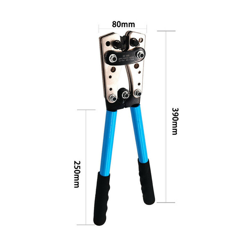

December 18, 20232 yr I recently picked up a pair of these recently for about £12 GBP (R50?)... ..and was pleasantly surprised that they actually worked OK. They can leave a bit of an 'ear', but if you make sure it's facing the back and cover with heatshrink, who's gonna know, right? I even cut a crimp open with an angle grinder after doing it, to see what it was like inside - pretty solid! Edited December 18, 20232 yr by HedgeSlammer
December 18, 20232 yr 24 minutes ago, HedgeSlammer said: I recently picked up a pair of these recently for about £12 GBP (R50?)... No not R50 but R282 today.
December 18, 20232 yr 😖 Oops, cheers Scorp007... I'd wondered why kit in ZAR looked so expensive to me. 😅
December 18, 20232 yr 15 minutes ago, HedgeSlammer said: 😖 Oops, cheers Scorp007... I'd wondered why kit in ZAR looked so expensive to me. 😅 Way back in the late 1970's it was R2 a £. The good old days. 😀
December 18, 20232 yr 1 hour ago, HedgeSlammer said: I recently picked up a pair of these recently for about £12 GBP (R50?)... ..and was pleasantly surprised that they actually worked OK. They can leave a bit of an 'ear', but if you make sure it's facing the back and cover with heatshrink, who's gonna know, right? I even cut a crimp open with an angle grinder after doing it, to see what it was like inside - pretty solid! One of the crimpers that I use also leaves an ear and I just file the ear down so that it does not damage the heat shrink when the heat shrink is shrunk.
