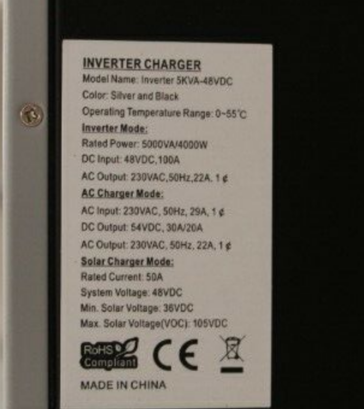

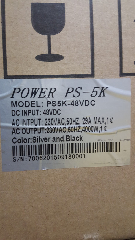

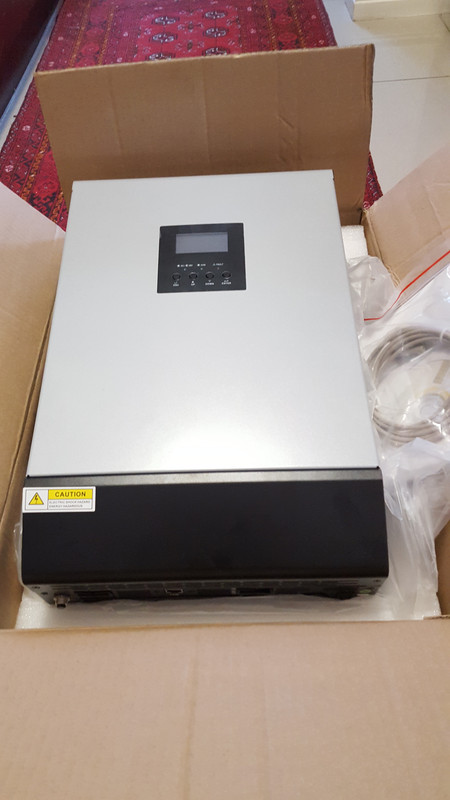

To start of, the Inverter I Bought a month ago on a stock clear out for a really low price is a Power PS5k-48VDC "looks like a clone of the Axpert/Mecer -voltronic". looks like it is made by Conpo Power tech or by Snaterm. "More info on this will help". I only founded out this week after doing some google hunting that it's hybrid with PWM solar charger. Will post some photos. I will live with it for the time being till i got more money to upgrade on this part.
Some photos of the inverter:
To what I can made out on the serial bar is that inverter is made on the 2015/09/18 if i'm correct. Some can shine more light on this for me.

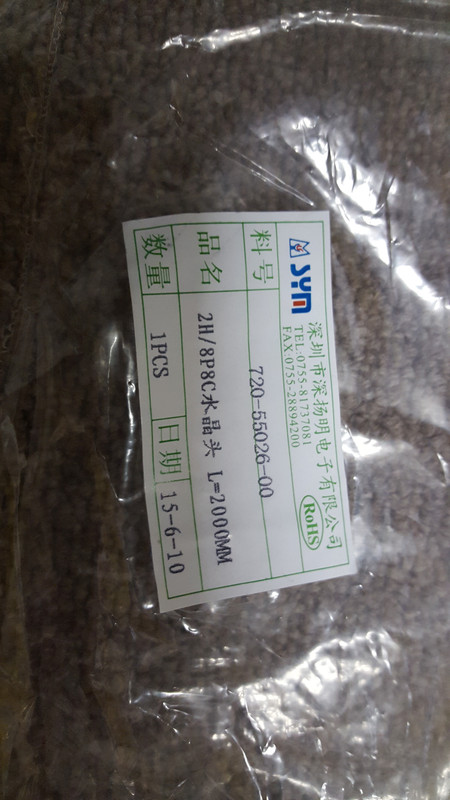

And to the cable date:

Plans is to run 12  260 watt AE Solar panels. The inverter rated solar charge current is 50A and Max Solar Voltage is 105VDC. Still fiddling around if I must run 2 panels series and 6 of this in parallel, or 3 panels series and 4 of this in parrallel. I will like your guys input on this. Max power of the the panels is 29.99vpm and 8.67 Imp (A)

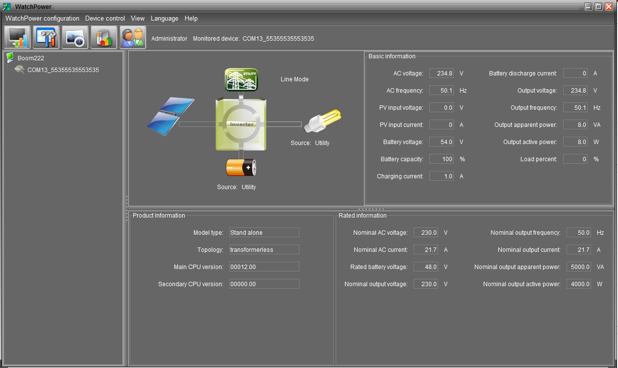

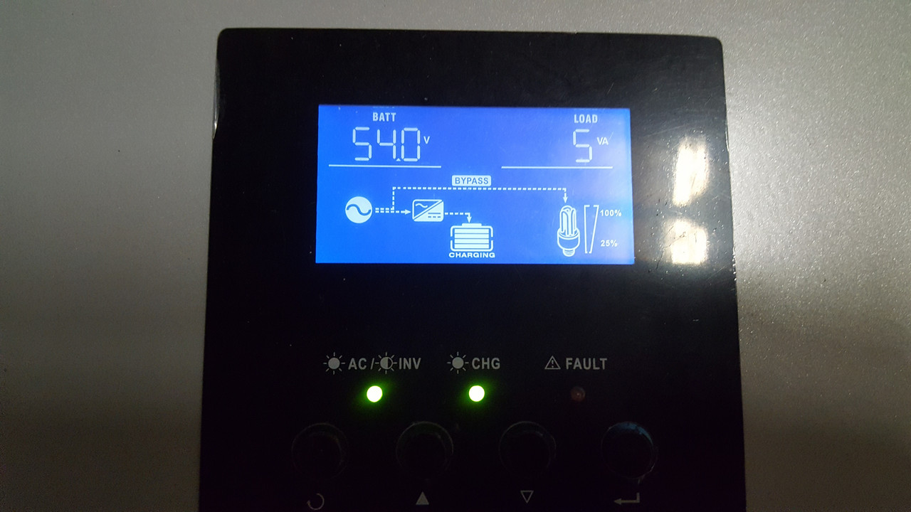

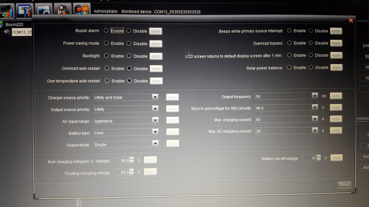

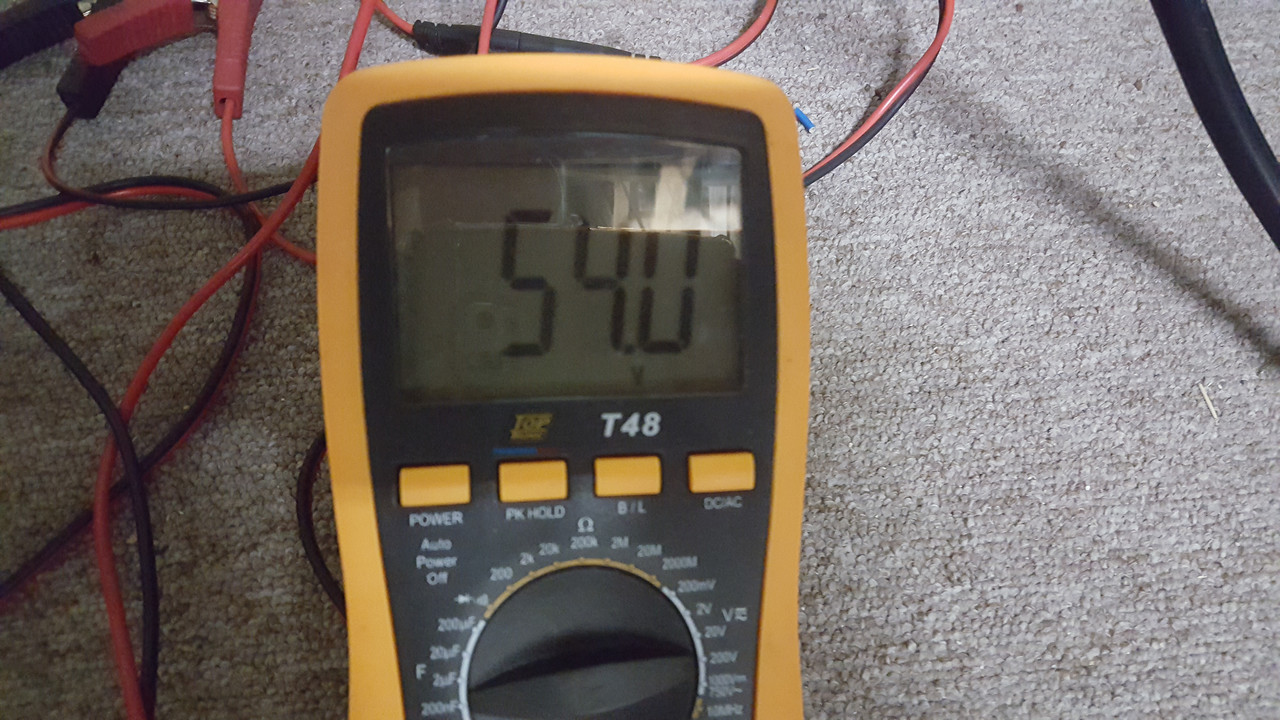

I started the inverter up on Monday from the grid power with the batteries connected to it to. Went over to charging and plug in the serial to usb cable to get some more info from the inverter.
Looks like the info that the display is showing for charging the batteries is spot on and as it change, it change the same on the volt meter.

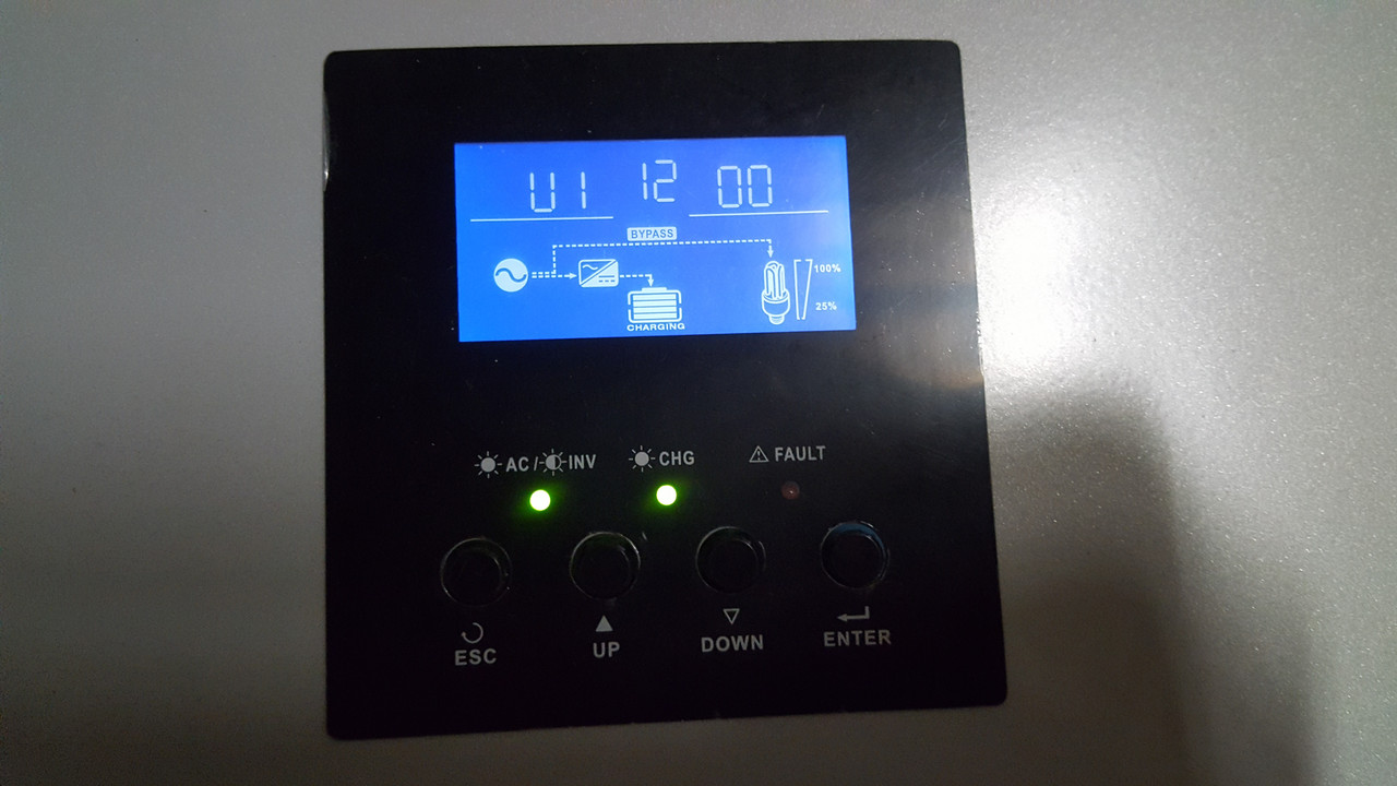

Know the head scratching part begins, on the inverter it shows that the firmware on the unit is u1.12.00 Is this super old Firmware on this unit? What is the possibility that I can maybe check if i can maybe update this drives to something a bit newer?  Did a bit of read-up on the forum about it. Lets hope this will not break the inverter.
Looks like when I change the battery type to USER then it gives me freedom to do changes to the settings
All your info and help and input will be highly appreciate.
Just keep in mind this is Voc and not Vmp. So this might determine 2 or 3 panels in series.

No problem, found some specs on the inverter and they refer to Max Voc PV of 90V.
Either way I would not risk more than 2 in series for 90 or 105V.
Max Current 50A, would then also limit you to 5 strings.
No, it just means it's probably not genuine Voltronic Power firmware, or even a direct copy of one. Though it is possible that it's a V. P. firmware that I've not come across. Certainly, the firmware versions don't merely get bigger the more recent they are. As an example, version 72.20 is more recent than 72.40, and they are for different models (and not compatible with each other).
Edit: yours seems to be a PWM model, so it won't be compatible with most available firmware updates, certainly no patched firmware.
@Coulomb thanks for the info. Maybe i need to check inside the inverter and to see if there is any info on the pc board.

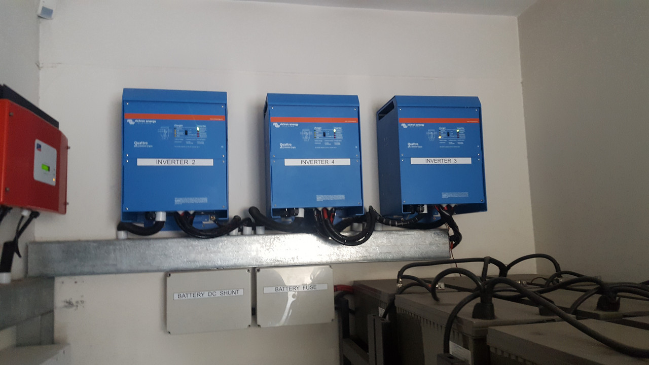

Let me tell you about my evening. I was completely unaware that we had moved into stage 2 and that we had a 10PM slot. So it's about 22:10 and I'm in the kitchen cleaning up the coffee machine, wife's still sitting with a kid having trouble sleeping... and the next moment the house lights starts pulsing and it makes this really weird noise followed by complete darkness. In a split second I realised 1) the power is out, 2) we just overloaded the inverter.
We'd forgotten an air conditioner on in the main bedroom. Normally the inverter will run it, but last night we had just a few too many other loads also going.
So despite the trip: I didn't even notice the power was out. That really is something 🙂
