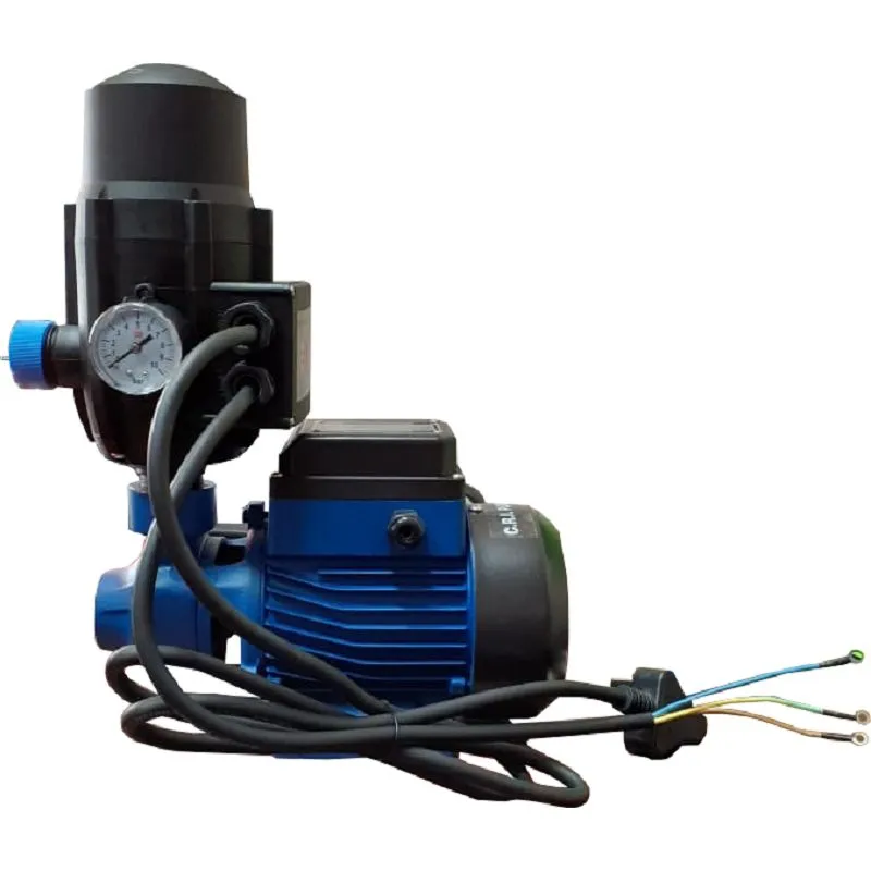

Have been using the 0.37kw pumps with pressure switch. They are inexpensive, with a reasonable flow rate.
We have one on our rain water tanks, and another on our mains water supply with 2kl storage.
Over the last 10 years have replaced both pumps, about 2-3 years back due to pressure switch failures, and it was cheaper to buy the complete pump with pressure switch, than just the pressure switch or pump.
Noise levels on the pumps has varied by brand, and I cant recall it being quoted on the pump spec data.
One of the units purchased over the years was quite high pitched whine, the others seemed to be much less so, more of a humming sound.
The cost of the units ranged from around R1000-R1300 over the years.
