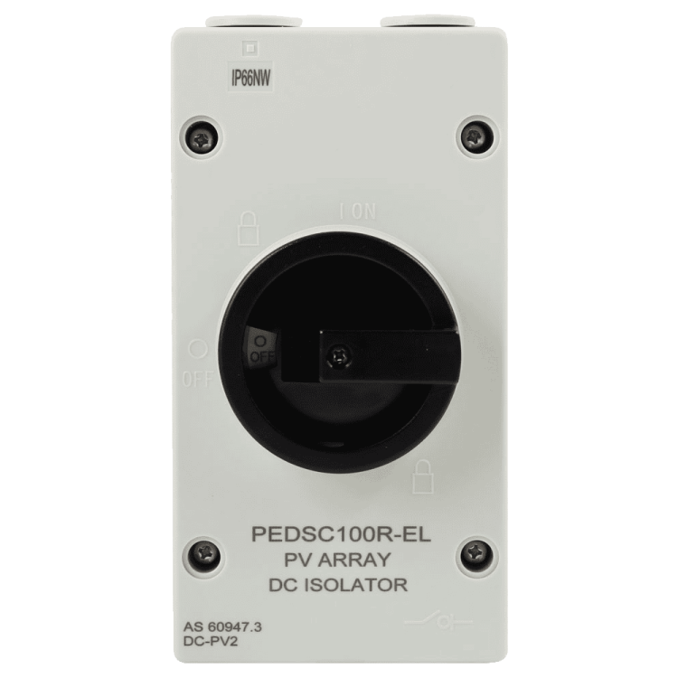

January 11, 20251 yr 7 hours ago, chrisc said: The customer has 4 x 550 watt Canadian panels, all wired in series. The installation was completed in August 2023 10 days ago it was noticed that there was 0V input from the panels on the inverter's display Investigation found that the +ve and -ve MC4 connectors at the -ve end of the string had burnt tubes. Replacing both made the string produce 180 volts and 8.4 amps. The damaged MC4 connectors were securely joined together and had been cable-tied to the rail under the panels. These were the MC4s that came attached to the panels on a flying lead That is the reason i use a 1000v 32 amp dc isolator to test ISC( short the string out in good sunshine) take a current reading compare to specs then leave for 1 hour and the guys feel each mc 4 connetor for bad seating and incorrect crimp connections.( heat) Never use the mc 4 connectors at the end to do this test as you will destroy the connector when you disconnect( huge arc).Below dc isolator i use for this test with leads and mc4 connectors attached to the contacts. All this is done before connecting the strings to the dc combiner.

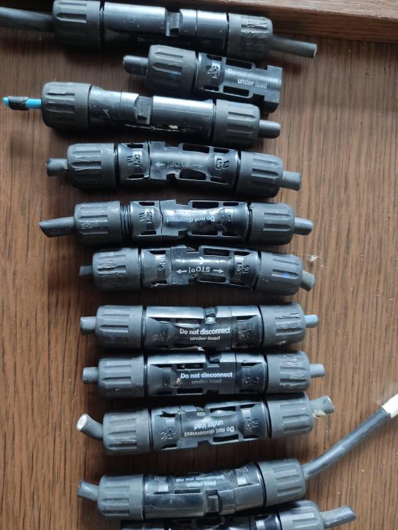

January 11, 20251 yr 11 hours ago, chrisc said: The damaged MC4 connectors were securely joined together and had been cable-tied to the rail under the panels. These were the MC4s that came attached to the panels on a flying lead Most of the times the crimp itself is good, but the internal pins of the MC4 are not in the proper position (there must be audible click sound for each connector during it's completion, male and female..and then a third click as you plug them together.). See thread here: Speaking of incompatibility, the best is to buy a bag of MC4S, cut the connectors from the starting and ending pigtail of a PV string and crimp the same type of MC4 to that pigtail and to the "downlink" cable too. BTW: burnt MC4s are pretty common. A coleague of mine does repairs and checkups of large industrial PV parks and saw hundreds of burnt MC4 connectors already. Some of them were even smoking and melting just in front of him. Edited January 11, 20251 yr by Youda

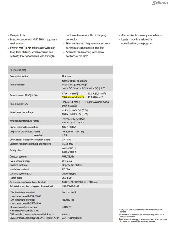

January 12, 20251 yr 27 minutes ago, chrisc said: You would expect a premium brand PV panel to use quality MC4 connectors. The inner metal parts overlap 8mm as far as I can measure and in full sun deliver about 35 volts and 12 amps. They are pretty decent. Most of the issues are happening at the start/end of the strings, where you connect panel to the "downlink" cable....and therefore MC4s from different vendors are mating. 29 minutes ago, chrisc said: Is that thin tube adequate to handle that current? Yes, it is. 30 minutes ago, chrisc said: 230 volt mains plugs have far more substantial and robust Not really. They look like, but try to run 32Amps thru 230V AC plug for 8hrs in a row and you will see. Not to mention that 230V AC plugs are not IP68 rated. MC4s are. 31 minutes ago, chrisc said: I spoke to the supplier. He said straight away that I must have not connected them properly as he had never heard of such "nonsense" since he started his business Oh yes....: WhatsApp Video 2025-01-11 at 19.53.19.mp4
January 13, 20251 yr 14 hours ago, chrisc said: You would expect a premium brand PV panel to use quality MC4 connectors. The inner metal parts overlap 8mm as far as I can measure and in full sun deliver about 35 volts and 12 amps. The Staubli connectors that come with the panels are about as premium as they get, they stuff that is usually mated to it is usually far from it. The connectors have a completely different structure than what you get in a typical wall plug - look inside the female and you will see they have a number of spiral or straight contacts made from plated spring material. This arrangement ensures much better contact than the (usually 2) contacts in an AC socket. 22 hours ago, Bl4d3 said: MC4 is not only a connector type, but a standard, I'm pretty sure that's not true, and also the source of many of the problems.
