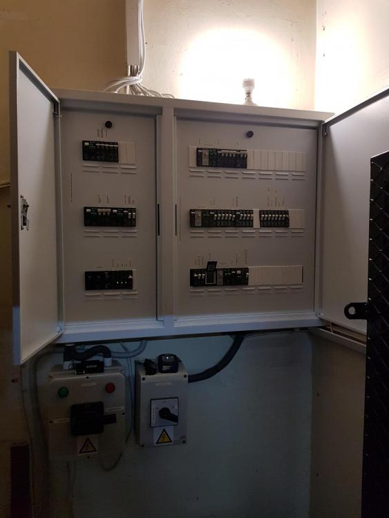

I have just done mine with Schnider easy 9 domestic range . ABB are great but as @plonkster said they are not cheap . I would look at hager or Schneider for a cost effective solution .

Tell us about that Arduino relay board on top??
I have a Samsung smartthings platform running , this board connects to smartthings and is used to switch the contactors in my DB .
I use for swiming pool , geyser control , and have 2 spare for now .
The contactors are neat - are they Schneider too?

Very very neat, compared to my current mess. This is more or less where I want to end up. Where did you buy the DB Board and rest of the kit?
I got the DB from ACDC , the switches are available from Voltex . I really like that DB you are looking at . You should do a full hager install .

The schnider ones are not cheap ! I only took them due to my OCD , Hager and Chint also do them for a much better price . Mine are 25A .

@Mstott just checking your board layout again,  would you mind summarising what is happening on each row?
