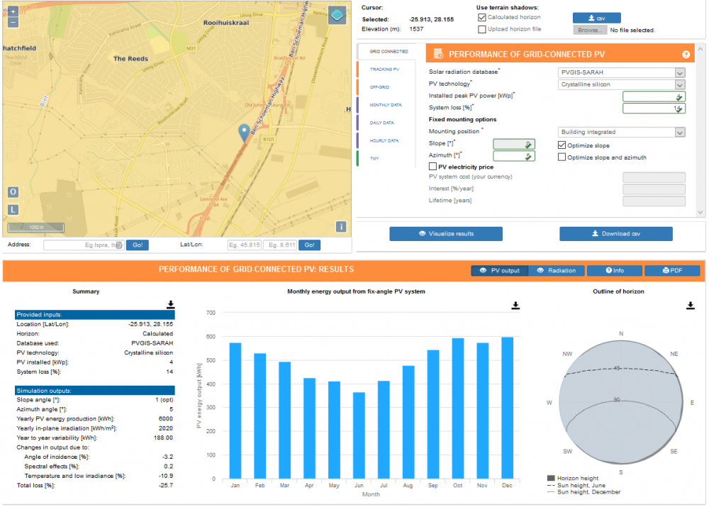

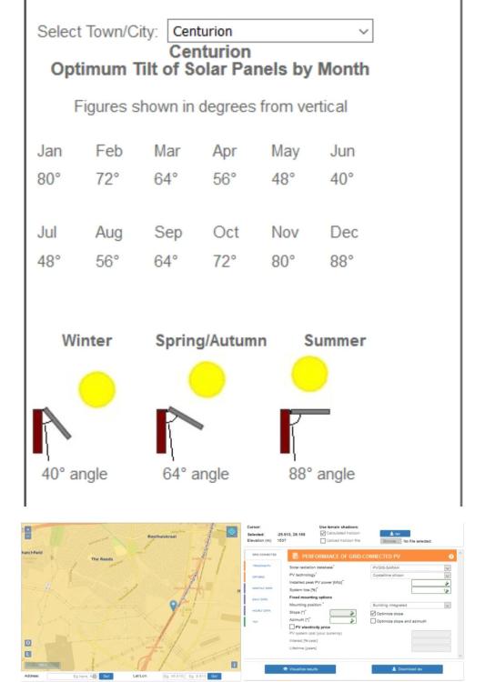

I have seen both the calculators posted above before, and have made some notes to try and optimize my setup once I am able to get to the buy and install point. Anyways, I was under the impression that my roof at 26* tilt, and approx 5* azimuth was quite good for an all-round setup. However, I've just played a bit with the "JRC" calculator a bit more just out of interest, and used the "optimize slope" calculation on the site. Apparently 1* tilt is the best according to the calculator?
Calc1 is the one off the solarhandbook's page, calc2 is the calculated 1* tilt, calc3 is using the same angle as recommended as per solarhandbook's page's result.
@Minerva10210 I have played around with the JRC calculator quite a bit too, and to be honest I think it may contain a few bugs, especially when re-calculating after changing values.
If I open the site fresh, and input the details for optimal slope and azi at your location, then I get (very) different results:
That is more what I would expect given your location.

Hold on, I think I may have the Azimuth angle in wrong there, I was assuming North as 0*, and I now see they seem to be basing their calcs by default to be Northern Hemisphere - so my input might be out by 180* :o
