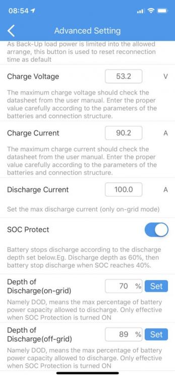

The DoD setting on the Goodwe is 80% but looking at the lights on the batteries, it actually draws down to less than 10% SoC.  And for some reason I can't seem to change the DoD setting using the app.  I really need the Pylons and Goodwe to talk to each other.
