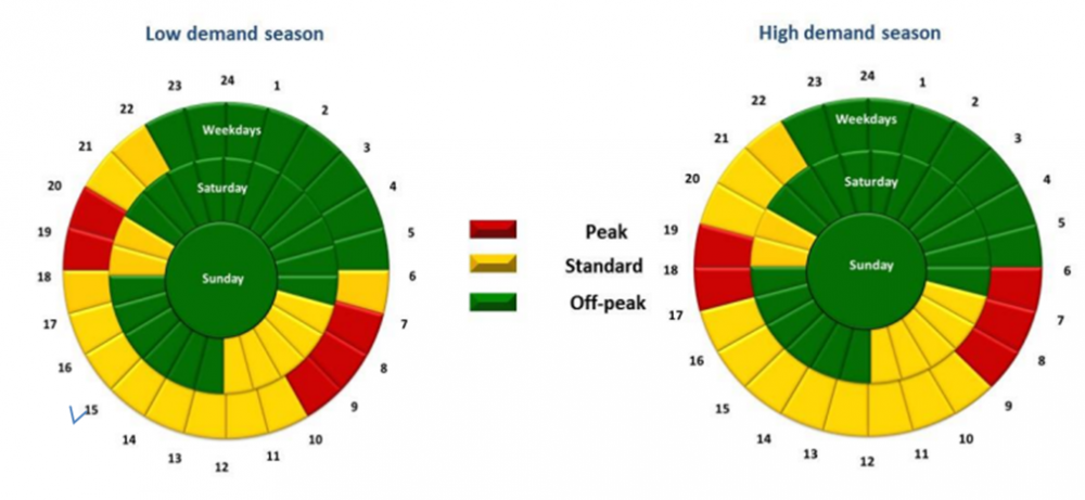

I ve been away from forum for a bit so missed some of the action - some nice dashboards. I ve expanded mine quite a bit in Homeassistant since I posted last. Related to solar I now have a automation which is quite specific to PE Grid tie setup which you might find interesting. If you grid tied you linked to Eskom time of use time periods so you really want to be careful to get your system to only draw from grid in off-peak and standard time. Rate peak is R2.67 vs off Peak R1.24 / kWh.  Now since the Peak is never during high sun conditions you need to be able to tell the system to use battery first during Peak period, then ouside this period you tap into cheaper time periods to recharge the batteries for the next peak. Should mention any excess power fed back to grid during the day can be used as credit in evening as long as the rate periods match - effectively you using the grid as a battery. That way Battery only needs to be sized to house consumption during the 2 peak periods - see power wheel image.
So home assistant keeps track of the rate periods and battery condition and sends a command to my quattro inverter (well actually ESS) to adjust the grid setpoint up or down depending on what rate is active - works like a charm.
Other toggle relarted to solar is a loadshedding switch - basicaly this tells the inverter to increase battery SOC min to a higher level (mine is 40% vs 20%) - to ensure there is enough capacity in the battries at all times to handle a 2hr unexpected loadshed (have toyed with trying to read the shedules but gave up)

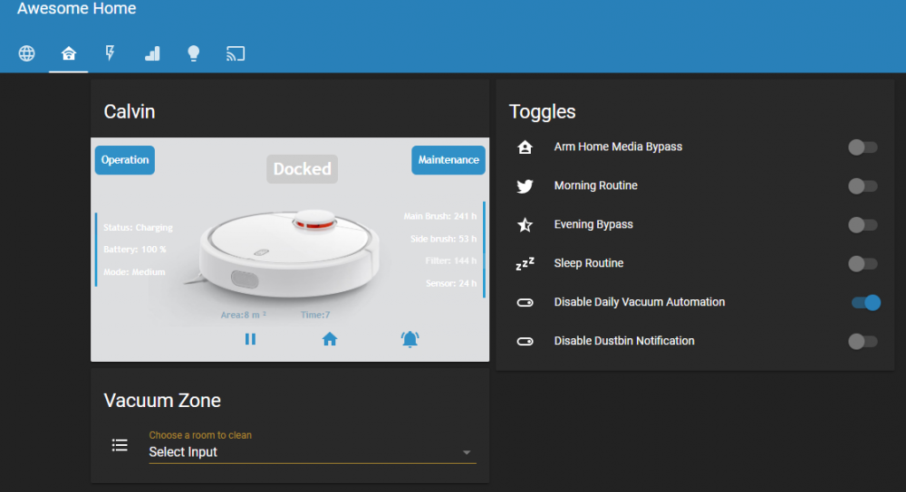

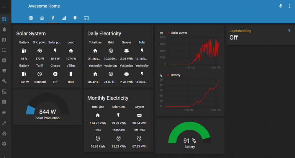

On 2020/03/12 at 3:34 PM, Mark2 said:
I'm also a big fan of home assistant.
This is my dashboard for my Axpert MKS II. I have a raspberry pi connected to it with bidirectional MQTT to my home assistant server.
The server used to be just a pi 3 but it started getting a bit sluggish with all the data points. I've since migrated to an old 4th gen i3 with a cheap SSD
I've done some other stuff as well if you guys are interested to see.
@Tim where do you get these rates from? I checked on the Eskom site but can only seem to find old rates from 2011/12 14/15 etc... Could be that I'm looking in the wrong place.
