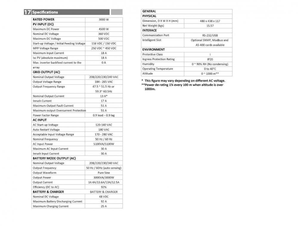

Thanks Jaco,
I am cycling the batteries at night but limiting the discharge on the batteries to 20a, so the rest of the power for the load comes from the grid side.
The battery bank is 2 x US3000 and 2 x US2000.
Inverter is only 3kw though, Infini.
Am I being too ambitious with this plan based on the inverter size?
Edited by francois
5 minutes ago, Jaco de Jongh said:
No I dont think so. Brand? and what is the inrush current its rated for?
It's a 3kw Infini Plus.
Sorry for the blurry spec sheet. Hope it's readable.
Edited by francois
16 minutes ago, Jaco de Jongh said:
From what I read here, you should be fine.
Just ensure your maximum load does not exceed 2.4kwh..
Perfect thank you Jaco.
