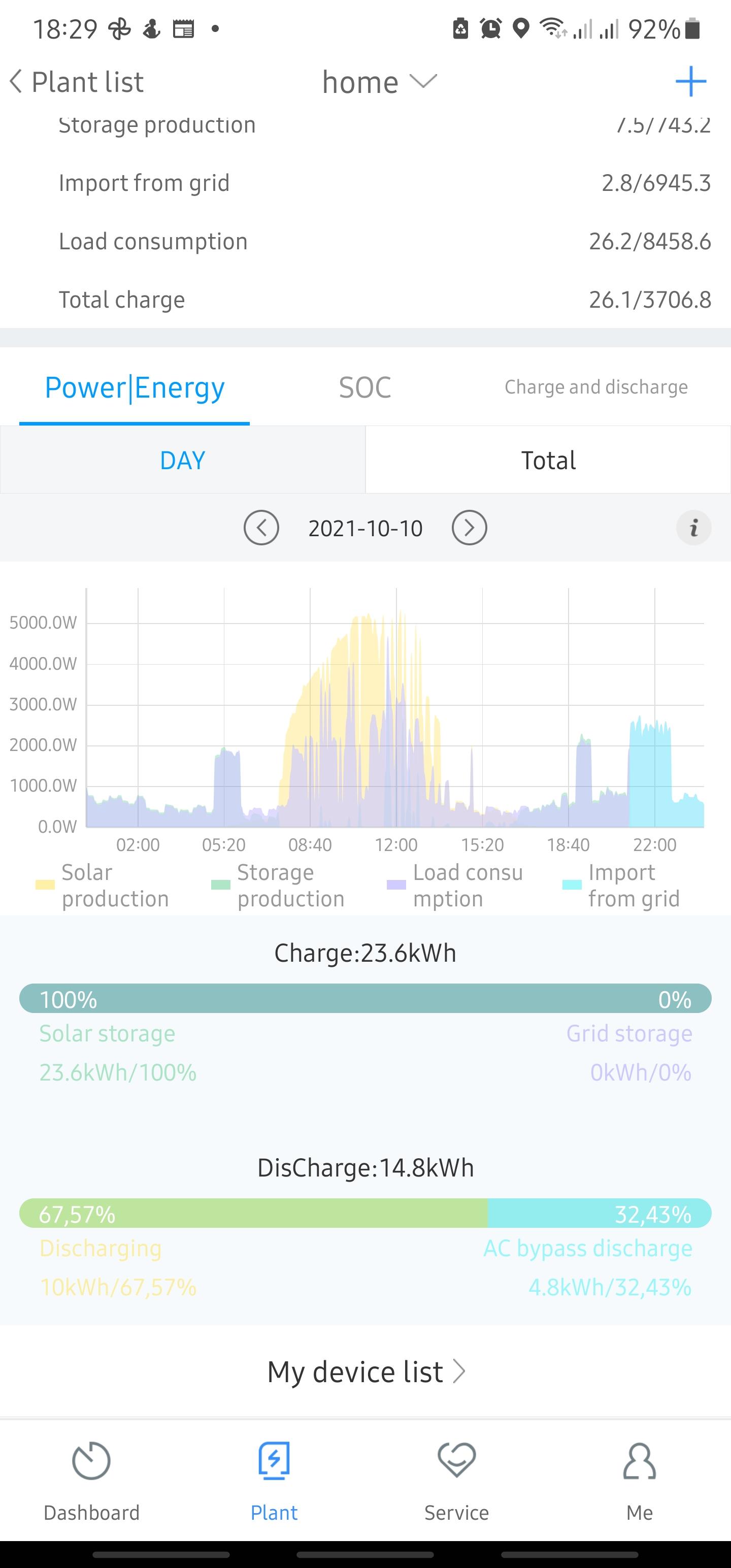

I also don't have water under floor heating I do have a 5kw heat pump.
It uses around 1200 watts for about an hour to heat 200 litres of water to 55 celcius. I don't even notice that it's on when the sun is up.
If needed I power it from the batteries. As you can see on the screenshot at 5 am.
BTW the 3kw heat pump only uses 800 watts.

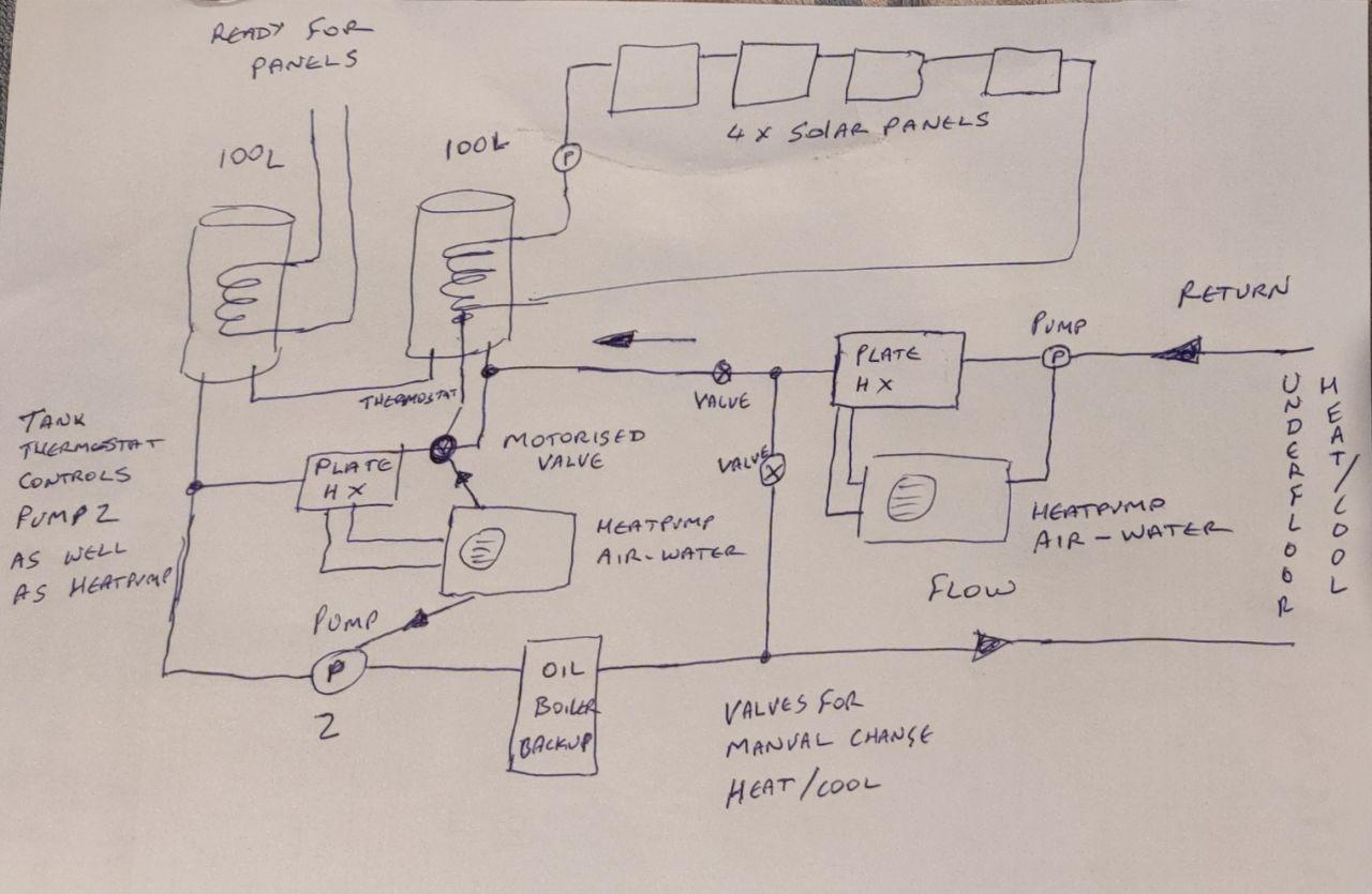

I have underfloor heating (and cooling in the summer) running off a heatpump (home made system in my case rather than commercial). I would recommend underfloor heating to anyone, best heating system I've ever installed).
In my case (North east Spain) I heat the water to typically 32C in winter and chill to 16C in summer, this keeps the house at around 25C in summer and 22C in winter.
As there is a time delay on the response I use a weather feed and predictive heating based on forecast temperature, always working 2 hours ahead. I also reduce the temperature a few degrees overnight in the winter.
My house is approx 250sq meters and electricity use is between 6000kWh and 8000kWh (depends on the winter!) for a heating season from mid October to mid may.
In my case I have also added (and soon to add more) solar water panels to the system so on sunny days I get free heating from the sun. As the underfloor is effectively a thermal mass the heat is available long after the sun has gone.
Another future plan is to add an extra small heatpump that operates when I have excess solar power. This will most likely only be for summer cooling use and 'emergency' winter use in case of grid failure.
@Acuario Do you have a storage tank for the hot water from the solar panels and what is the volume in litres. Also are your heating pipes embedded in the floor slab or in an isolated concrete layer above the floor slab. Perhaps you would be so kind as to describe the your hydronic floor heating system a bit more comprehensively. I did embed pex pipes in my concrete floor slabs when building the house and am trying to figure out the most effective way of producing the required hot water. In the Western Cape Province of South Africa, where I live, we have a fair amount of sunshine in winter but our electricity infrastructure has been badly neglected and willld probably fail at some stage. We are already having frequent rolling blackouts and electricity prices keep escalating. So I think it is time I put the pipes in the floors to work.
The system I have was retrofitted in most of the house but the principle is the same. I had tiled floors that were on top of a weak cement/gravel layer, that was on top of a concrete slab. I removed the tiles and cement/gravel down to the concrete. I then used insulating panels like these to support the tubes. On top went a layer of cement with a plasticiser and then new tiles on top of cement layer.
My heating/cooling system (all home made and mostly from recycled items...) consists of:
I built my own controllers for both the solar controller and heatpump controller.
As an (almost) last resort I can run the oil boiler and circulating pump from my solar system if I don't have power to run the heatpumps. As an absolutely last resort we have a woodburner..
For anyone interested in building their own system like the above there are details on the Eco Renovator website, along with many other designs both of mine and other people.
