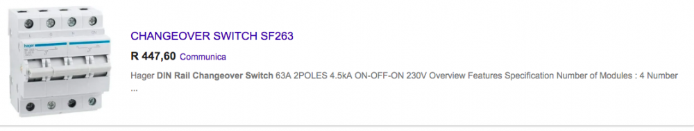

April 8, 201610 yr Hi All Has anyone got experience with these switches. I am keen to use them in my DB to allow me to switch loads between Grid and Inverter...? Quoted price at the moment is: R434 ex postage. for the 63A Regards Mark
April 8, 201610 yr I have Hager breakers in my DB. The guys at frontline (which is the BETTER supplier in town) says it's good stuff. I definitely like it better than any of the cr*p I bought at AC/DC. My changeover switch is however an AC/DC special and I will gladly throw it where the sun don't shine and use one of these instead if it is anything like the hagers I already have in my DB.

April 13, 201610 yr Just to add - The Hagar 63A one is great, but bear in mind it uses 4 Din positions (in case space is an issue), used mine as a Gen/Grid changeover for years, now it's my Invertor/Grid changeover. 40A is 3 Din positions.

July 21, 20197 yr Have a Hagar SF263. Got mine from livecopper.co.za which offers free shipping over R350.
July 21, 20197 yr You can’t go wrong with hager I think it’s good value for money. I installed the hager about two months back and have switched it +- 100 times since. I have put it through the test. When I switched over I done it in one fast motion so that even my computer and TV stay on. I don’t think its built for that but it can do it.
