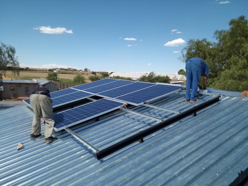

Christmas present coming for  Zupta
I have started with my installation today, and got the first 16 panels fitted. The Imeon9.12 is fitted and I should receive my power box Monday for fitment.
I manufactured my own brackets for IBR fitting, as I wanted at least 180mm clearance between the IBR sheeting and the panels. I also used 100 x 50mm lip channel as purlines and fitted Unistrut u-channels on top for fixing the panels. The brackets and lip channels is powder coated and should last many years. ( I hate any paint work ! )
I've got the brackets coated with a mix of all the leftover powder ( all different colours ) and it actually came out nearly black, but at a very affordable price!!
All of this made the frame durable, although fairly inexpensive compared to all the different quotes I;ve got.
Many thanks to all the forum members who assisted me so well with support, advice and sometimes just being there for me when I felt down !!
I have posted a few pics. Open for criticism and suggestions. Still a lot of work left for the next two weeks.
Cheers Guys !

The vertical brackets manufactured and powder coated = R 60 each = 30x 60 = R 1800.00
14 x 3m purlines @ R130 + powder coating @ R150.00 = 280 x 14 = R 3 920.00
16 x 41 x 1.6mm Unistruts @ 195.00 each = 16 x 195 = R 3 120.00
100 M8x60 Stainless steel Security Torx screws = 100 X 9.70 = R 970.0
100 x M8 30mm square stainless steel washers = 100 x 2.41 = R 241.00
Total cost excluding labour = R 10 051.00
Cheers
PS. The structure is for fitting of 2 sets of 20 panels each, one facing Northwest and one South east.
