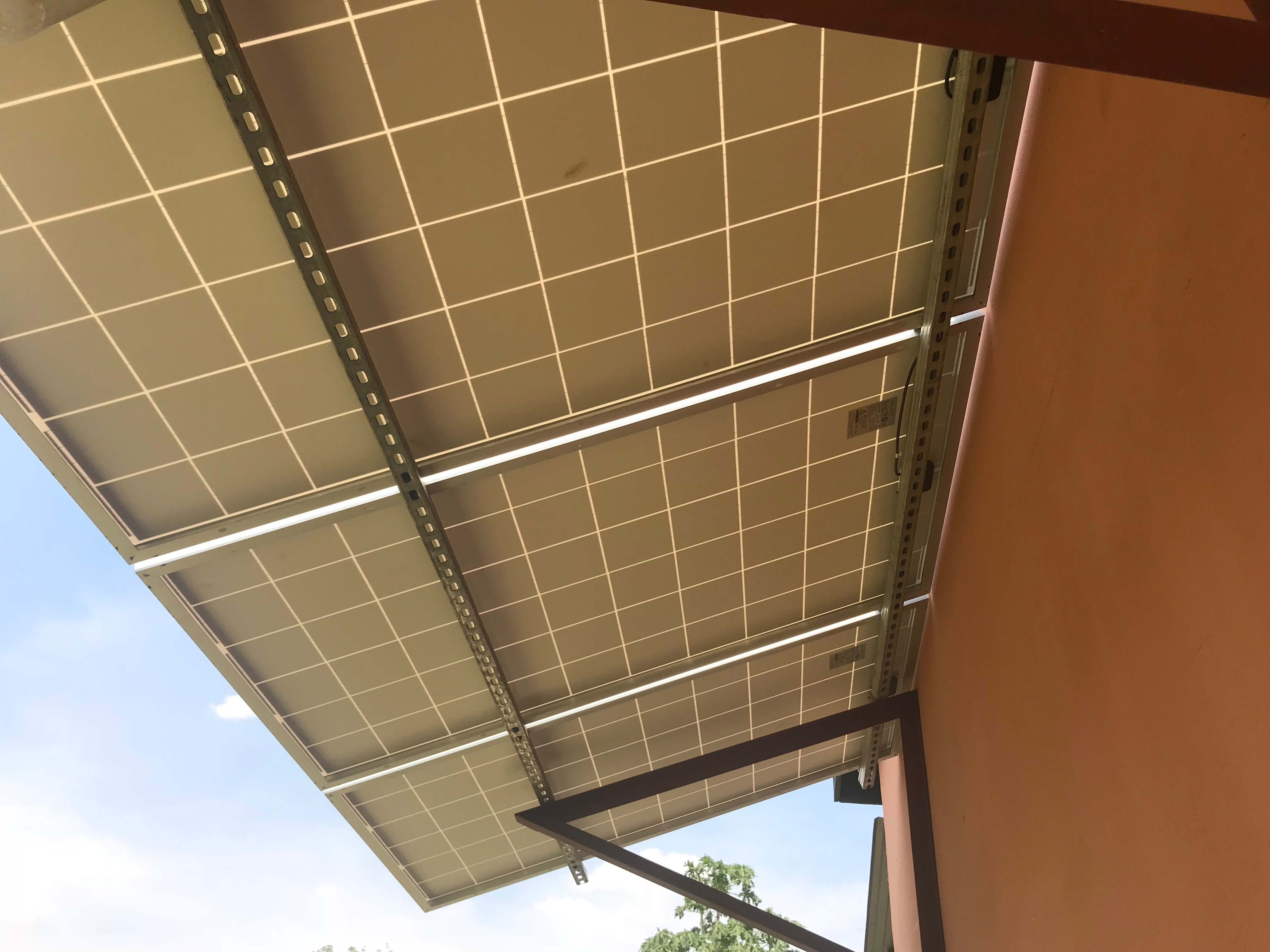

Decided to expand my PV by taking advantage of a north-facing wall. This called for some creativity on the mounting structure. The 6x JA Solar array turned out very nicely and well ventilated compared to the East-facing roof mounted Canadians.
5a01f65d6753b_Northfaceunder07-11-2017194748.thumb.jpeg.a6c60b1a51da92b3d816591a263ef155.jpeg
For the support structure weilded some 50x50mm angle iron and fixed to the wall with some robots. 6m mounting rails with aluminium end clamps and mid-clamps hold the panels together neatly I think. The mid clamps leave nice spaces for ventilation
5a01f6574c62e_Mounting07-11-2017195700.thumb.jpeg.af5debdea3b12e79032ba7a3b9c3daf7.jpeg
1 hour ago, Kalito said:
50x50mm angle iron
I have two frames made out of 40x40 angle iron. That stuff is insanely useful. The important thing is to treat them with the right kind of paint/covering. My one frame is holding up very well. The other one is rusting and I plan on replacing it with an aluminium frame.
