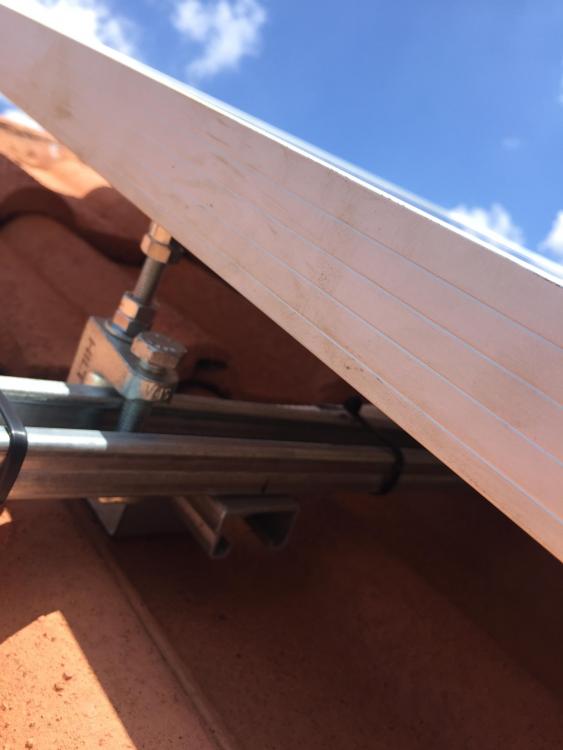

  • Here's mine. Unistrut connected with stainless steel angle brackets. I had the brackets lasercut and bended. Sikaflex in-between everything. Panels secured with standard mounting hardware, b

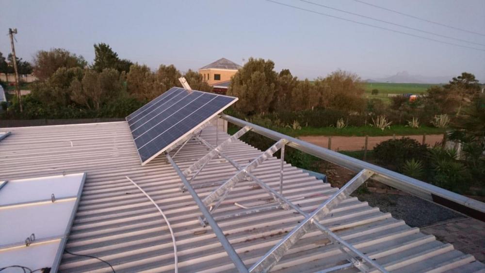

    I used 38mm square tubing and 76 by 38mm tubing for a 4 season manual tilt frame.. Mounted The panels mounted using Tek-screws (100 screws for 80 bucks).

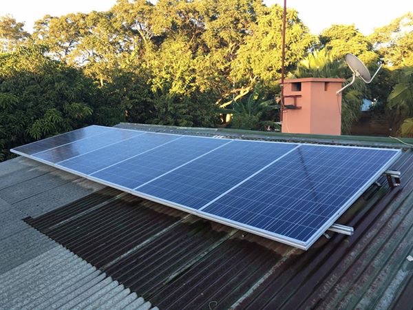

My East facing roof-mounted Canadian array gets full sunlight from about 7:30am. With hind-sight I would have left spaces between the modules as the spaced mid-clamps give for ventilation. On this used handy antitheft clips. The next DIY is to re-orient this array to face north. The roof slants at 10 degrees so some thought on the base frame in process.

Edit: I you check my panel mounting pics above you might notice Sikaflex everywhere between the different components...
Hi super, what was your reasoning for that, I have ordered everything I need to relocate my panels to the roof, also uni strut and similar clamps to the ones you used. Should start relocating next week / weekend.
Just want to see if i should maybe include what you have done with the sealant.

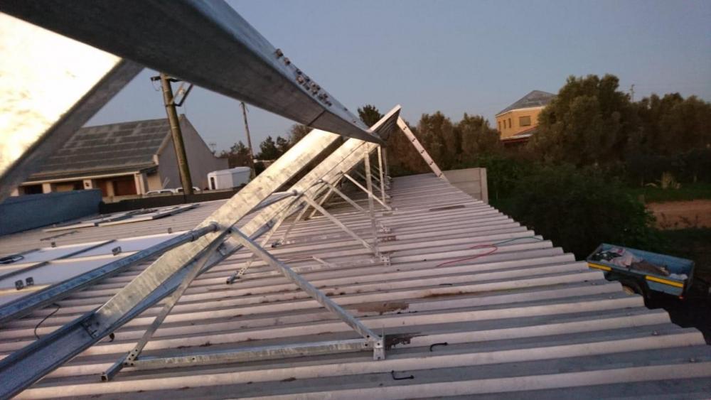

On 2020/07/31 at 3:41 PM, Anonymous said:
Hand made galv tiltable roof structure..
Has there been any comments on the effectiveness of this system.
I like the design and am curious to hear any comments on how this has worked/held up etc

On 2016/10/28 at 7:12 AM, Chris Hobson said:
I used 38mm square tubing and 76 by 38mm tubing for a 4 season manual tilt frame.large.Autumn_Winter.jpg. Mounted The panels mounted using Tek-screws (100 screws for 80 bucks).
Looks good I would have put it on wheels as well for seasonal alignmennt got to be careful with those tech screws
