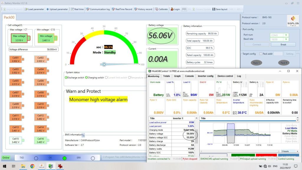

Valid point, however what happens if your Inverter and the BMS can't even agree on what the current battery voltage is.

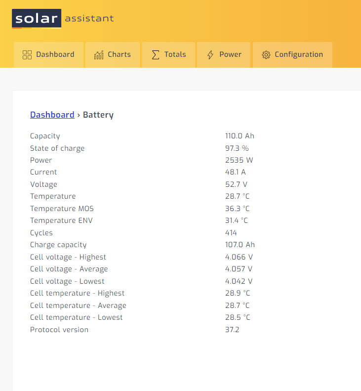

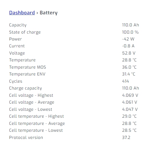

With SA I can monitor both and although my battery is still reporting full capacity after more than 400 cycles, I now do a monthly Voltage setting for 2 or 3 days to knock some sense into the both of them (so to speak), i.e. Inverter and BMS.
The issue is that my Inverter will report 53,6V battery voltage whilst the BMS is between 52,7V and 52,9V. I checked it with the Fluke  and the BMS is correct.
At this 53,6V reported Inverter voltage which stays constant from around 52,3 BMS voltage until its at 52,7V BMS I see how the capacity increases ever faster and the next moment it reports 100%.
When I set the Inverter to voltage charge (USE mode) then I have to dial in 54,1 V to get the battery to 53,6 V eventually. This then also reports 100% on the BMS. But now my cell voltages are in the 4,1 to 4,14 range whereas at the Li Protocol with 52,7V and 100% they are between 4,0 and 4,1V
Both are reported by the BMS as 100% and the charge stops.
So one has to wonder about who is in charge (Inverter or BMS) and why the Protocol (perhaps Inverter) uses it's own internal Voltage interpretation and the BMS reported voltage does not become the Master.
I have been monitoring this for months and initially I noticed that the 100% SOC was already occuring before the cell voltages even reached 4V.
Now that I do a Voltage charge setting once a month it has stabilised in the 4,1 to 4,15V cell voltage range when applying USE mode,  but the BMS will not get higher than 52,7V to 52,9V with the Li Protocol.
The Battery still reports 110A/h once at 100% whether its at 52,7V or the 53,6V with USE mode.
So what is one to believe?
My Battery lasts just as long as it did from the beginning, so from that perspective it seems to still have full capacity and I am satisfied.
Below are the screenshots of where the Battery is still charging just before 100%. Then the second set of screenshots are those taken right after the battery was at 100% and the  charge stopped and the battery went into discharge mode.
Notice how at that moment the Inverter reported Batt voltage drops to 53,1V

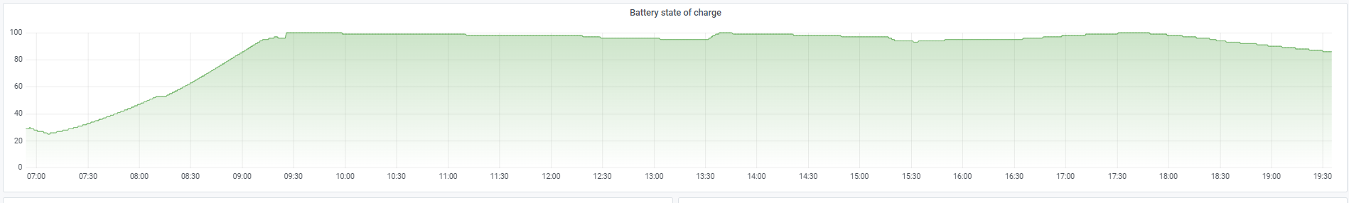

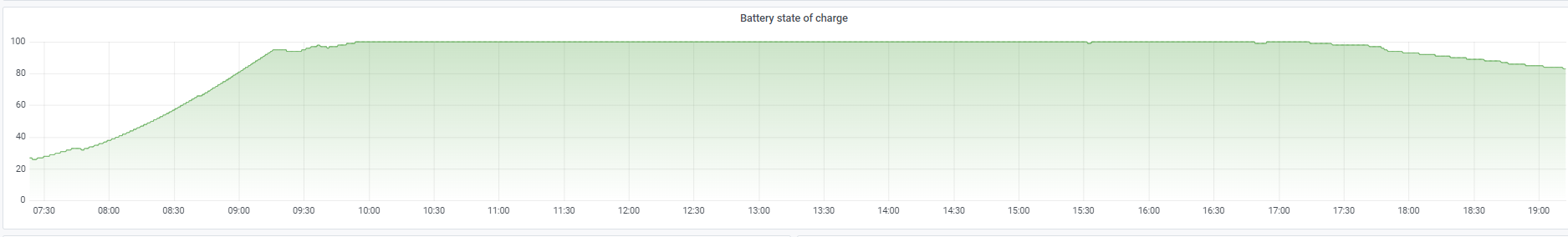

Here is a comparison of how my SOC reflects on a typical day when I use the USE mode settings and the second image of when I use the Li Protocol. And this second one is exactly what Growatt describes as their protective algorithm that uses the battery to power the Inverter as soon as it has reached 100%. It then uses the battery down to 95% whether there is solar or not, and at 94,9% it starts recharging. They claim it increases battery life and also prevents the charger switching on and off frequently. This can obviously only be validated if two identical systems (one in USE mode and one on Li Protocol) were put side by side over a 5 year or longer testing period.

32 minutes ago, zsde said:
The BMS comms via CAN bus with what I observe is more of an imperfect art than a reproducible technical marvel it's made out to be.
I tend to agree, even though I don't have personal experience, but from reading around the web it seems to still be very much a work in progress
This is also what my BMS does, it will charge to 100% and then only allow discharge until 96% and will then charge again. My inverter still powers the loads from PV though and doesn't use the battery much, it usually won't go below 98% by end of day like your first pic and doesn't hit 100% multiple times a day like yours does in Li. I have deactivated this once because I thought it was preventing the battery reaching 100% and it had the effect I expected; charged to 100% and stayed at 100%. I turned it back on after I figured out it wasn't the problem because I suspect it could cause the battery to get quite hot as it doesn't have active cooling.
Interesting to see the difference in the 2 graphs. It looks like, if the inverter doesn't get the SOC from the battery via comms then it doesn't use the battery as much as it does in Li mode. It seems the growatt algorithm is only active when it has comms (or accurate SOC). Looking at those 2 images my intuition tells me the second one would age the battery sooner as it is using it and cycling it more when it could be using PV.
The typical Li Protocol only powers the Inverter from the battery for as long as sufficient Solar is available to power the demand.
I have to disconnect the CAN comms when using USE mode else it will shutdown with an error.
USE2 mode is meant to be voltage control with BMS comms, but I found that behaviour identical to what the Li Protocol does in terms of discharge to 95% and the start to recharge. The USE2 mode is basically the same as Li except that user can dial in the voltages which is inhibited in Li Protocols.
