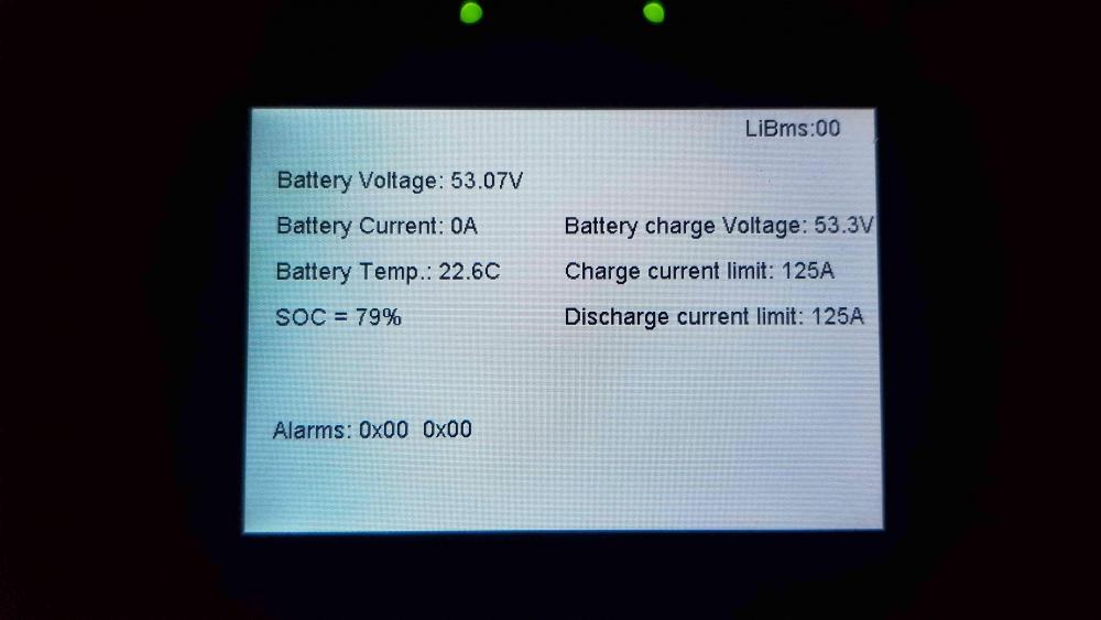

Hubble AM-2 SOC not going beyond 80%
I have a Sunsynk with Hubble AM-2 connected via CAN.
With the recent loadshedding my SOC is stuck at 80%.
Any ideas? Unplugging and reconnecting the CAN cable made no difference.
Switch on and Off the Hubble made no difference.

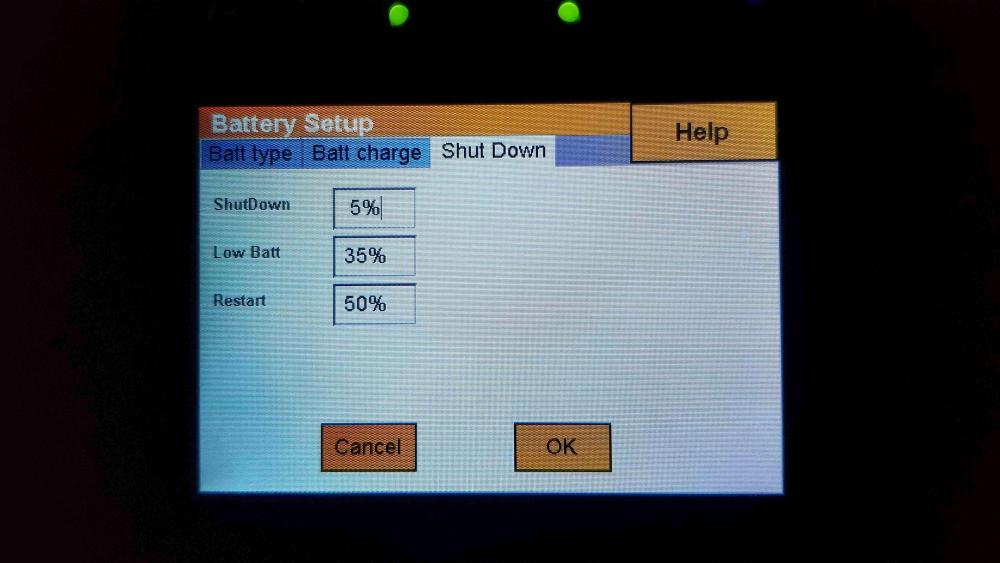

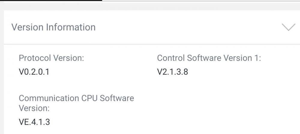

@swazz99jhb please post the screens from your battery setup page as well - Batt type and Batt charge.
You are running an old firmware, which potentially could be the issue but let’s see those settings first.

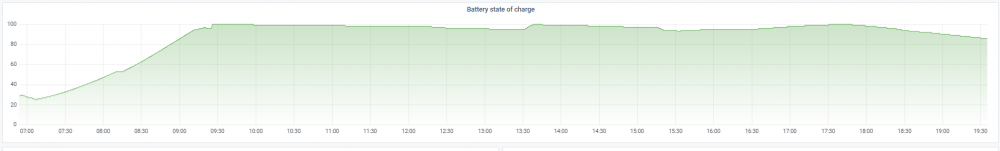

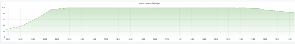

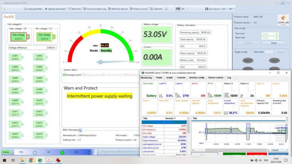

I have picked up a similar problem with my AM2.
I have my smartload/aux set to come on at 100Soc and solar set to 0w.
As soon as the inverter picks up the soc is at 100% the smartload will switch on.
Randomly i picked up that the smartload was not switched on even though the battery was not charging anymore and the Voltage was on 53v - full. The Soc gets stuck and is not current. I'll leave it for a while 30min plus and then it goes back to normal.

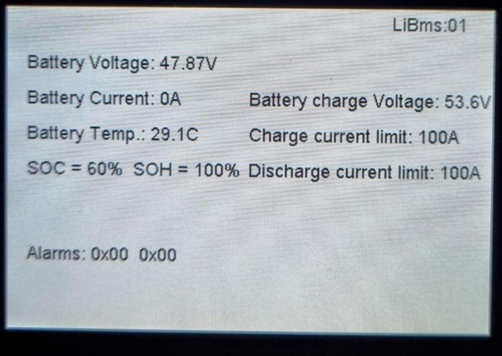

@swazz99jhb Ok, some of your settings are wrong!
Set Battery capacity to 110Ah
Untick BMS_Err_Stop
Set Float V, Absorption V and Equalization V - ALL to 53.6V
Change the setting below that, from 30 days to 0 days
Set Amps to 50A, you can try changing again back to 75A later, if the problem is resolved.
Post the charge state (LiBMS screen) after couple of hours with the new settings!

Done. Do I leave the CAN cable in? Thought all that stuff gets ignored if CAN is used.
