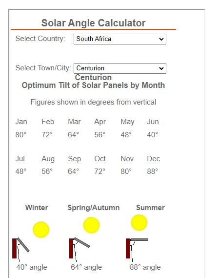

In Winter the sun does not travel as high in the sky as it does in summer, the further South you go the lower it gets so the more angled your panels need to be to get optimum power production.
There is a useful website that gives you the optimum no of degree's of inclination depending on your location.
http://www.solarelectricityhandbook.com/solar-angle-calculator.html

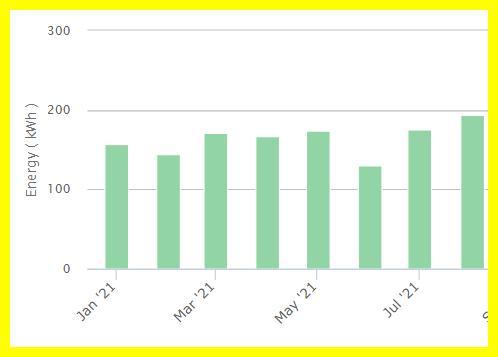

See attached about 10 days ago when my performance was 110% of design but since then it hasn’t been able to reach much more than 90%. I would assume the deterioration would be more gradual as winter sets in

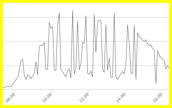

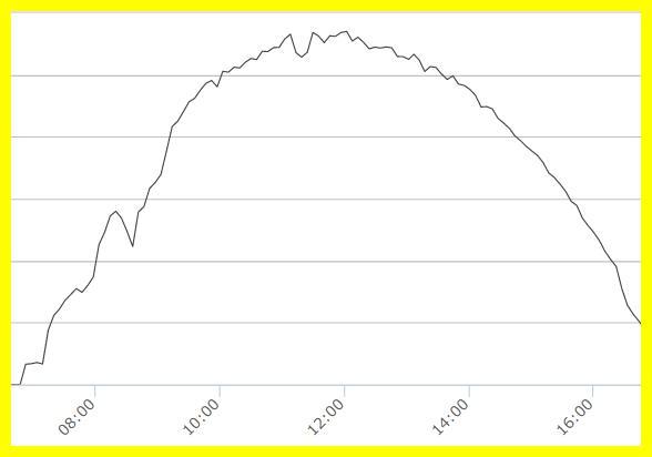

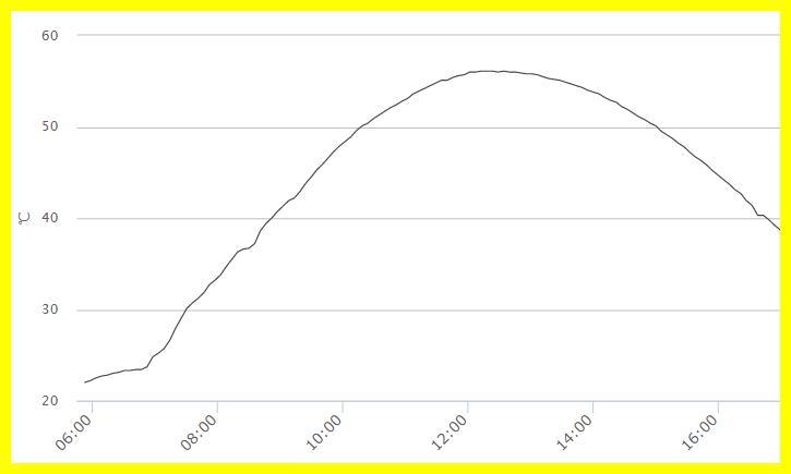

Temp is always an interesting topic. Why? My stats from the APP shows the highest power happens to be the time that we have the highest irradiation and also the time when the panels are at their highest temp as per the graph.
I belief the cells generate their own heat under high power. Thus the high output is at midday and at a temp over 50 deg when the ambient temp is 25-28 deg.
Power graph 07h to 17h and temp graph 06h to 17h.
Temp graph:
My winter production is not as low as most calculators would calculate. Winter days are shorter but with no cloud it get close to summer days with lots of cloud. Jan '21 to Aug '21.
My power peaks are still as high as during summer but only for the brief period of cloud edge. In full sunshine it is also down about 10%.
Yes. But the value would be even higher if the panels were cooler. Try hosing your panels some time. While hosing, the output will go down as the water blocks some of the light, but you will get a boost for a few minutes thereafter as the cooler panels have higher voltage (and less current, but that's a lesser effect).
I don't have a sample handy (and it's 1am here), but I notice when a cloud passes, my output briefly goes over where a smooth sine wave would have been. That's because the cloud allows the panels to cool, when the sun comes back out, for a few tens of seconds you have a cooler panel than usual, so you do better than the sine wave. Then the panel heats up again, and you go back to the sine wave.
If you don't see this boost after a cloud reappears, perhaps your MPPT isn't performing as well as it could. You also have to have pretty high resolution graphing; I have updates every 10 seconds (for 5 minutes total) on one of my graphs. I can't keep that going for the whole day, as it would overwhelm Node Red. But I have all the data there on an SD card. I'd drag it out, but 1am and sleep beckons.

Yes I do see those peaks during each cloud edge but I always thought it is due to the reflection from the cloud producing a short term higher irradiation rather than the slight cooling affect.
I have cooled the panels down by washing but the difference was very small. With tick marks 5 min apart the sampling is very slow but the MPPT is reacting quite fast. This I can see on the inverter instantaneous display.
Clear to see with lots of cloud how cloud edge higher outside the sinus wave. The sinus wave would be about 250W below the peaks.

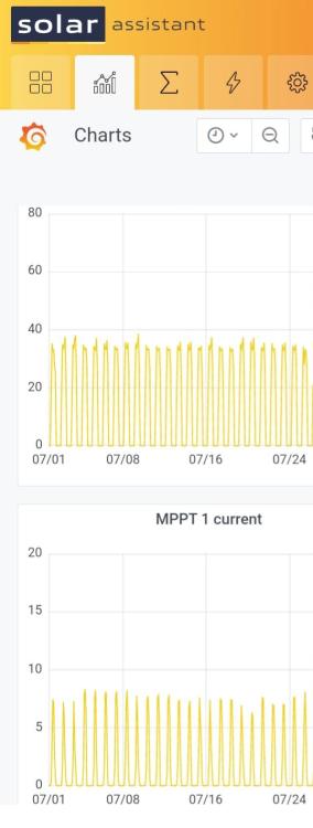

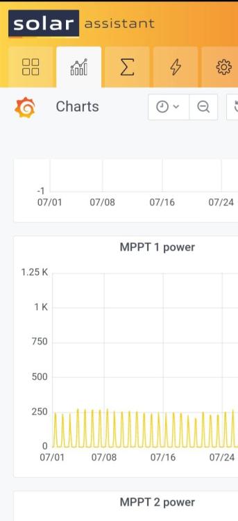

I agree Cpt is on average lower output during winter months due to rain and overcast conditions. As our trial in Gauteng (Alberton) revealed these figures during July this year and even in Gauteng your output is cut in half.
What is interesting is that the voltage output is above Vmp namplate value and consistently very close to Voc.
