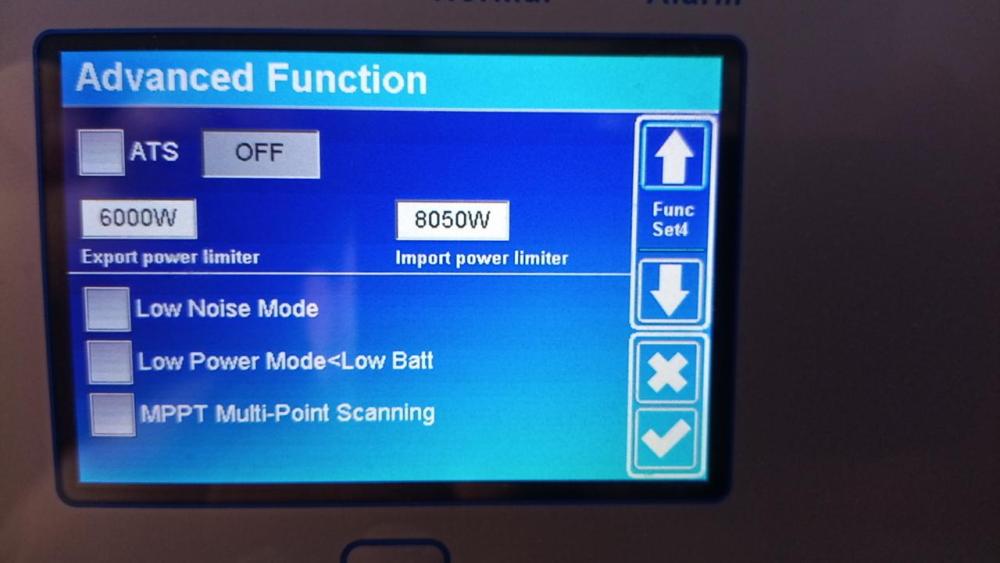

Sadly, the 15kHz noise is still there. There are a few new settings under the Battery section, something along the lines of "Quite Mode" is what you are looking for, to change it from 15kHz to 20Khz.

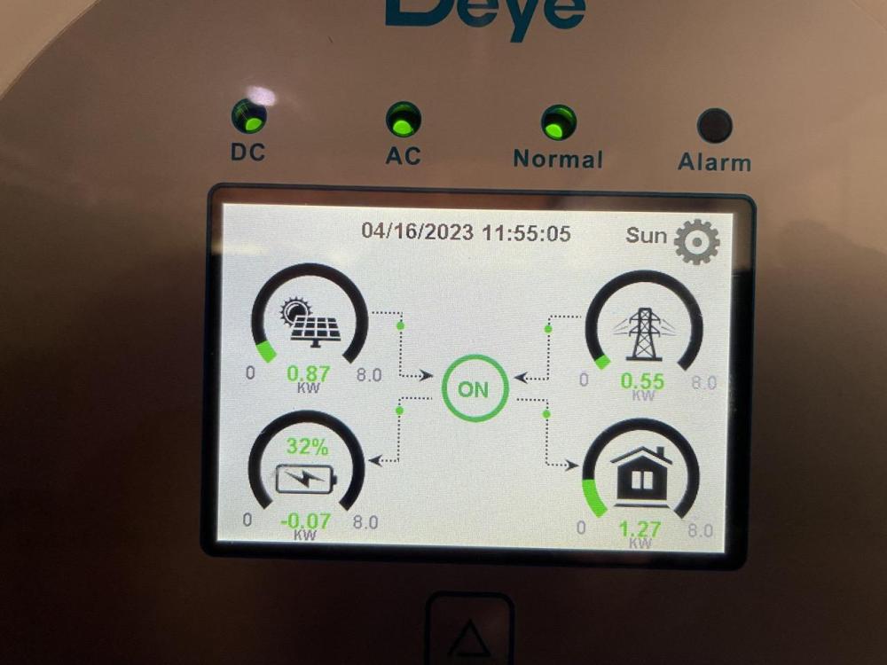

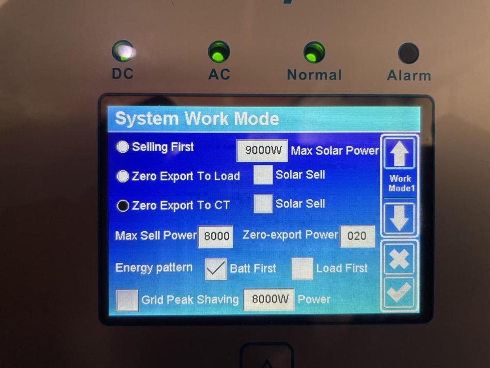

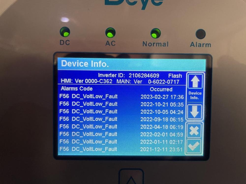

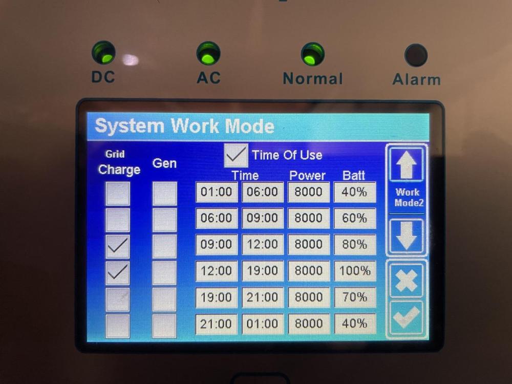

Hi All
I have upgraded to the latest firmware that Deye support sent me for my Deye 8KW inverter.
Since the upgrade I have had a lot of issues. The inverter does not behave like it should.
If I set it to prioritize the batteries, it does not do it.
When I set the Grid to charge the batteries, it still does not do it.
Is there anyone with the same issue? Can you downgrade firmware? If so, does anyone have working firmware to upload for this model?
Current Firmware:
HMI: 0000-C362
Main: 0-6022-0717
8060B7E4-9695-4314-B359-4C6582B0ACF8Large.thumb.jpeg.7472eeb4349d15ac244e1c651f734067.jpegA12598B0-70F7-4A0C-BD1F-524BABF9B0E2Large.thumb.jpeg.2506d1becbbd5196842c263a5fe5d147.jpegB9A8FB7A-A9BD-436F-8EFF-4E5C633DE08ALarge.thumb.jpeg.b70455f7837ed333f6b71f10b9b50bbe.jpeg
07B88885-9005-4B50-9191-8ACAB6FB7301Large.thumb.jpeg.5a933540ff6185027326b29b64414cc7.jpeg

Why are you asking technical support questions about battery charging problems in a thread about firmware versions? Your request for help is less likely to be seen here and you are pulling this thread off-topic for other people who are looking for firmware versions. Don't do that guy, start a new thread!
P.S. All the problems you have mentioned seem to relate to batteries. Check your battery settings in the inverter, if the voltages are wrong then that could explain why your inverter has been complaining about DC Low Voltage for more than a year.

I posted it here as the problems started after a firmware upgrade, so that people are aware of the issues with that firmware version and don't have the same issues as I have had and ignore/skip that version.
Deye sent new firmware which resolved the problem.
So the problem were never the batteries, but firmware as everything worked perfectly before and after the faulty firmware.
HMI: 0000-C362
Main: 0-602-0717

Ah, fair enough. Thank you for this post ^^^ with the resolution details. I'm sure that could help someone.
It looks like you have a newer Human Machine Interface (C362) than what I have (HMI:VC.3.5.D) but they seem to have downgraded your main firmware slightly from 6.0.2.2 to 6.0.2.0. When I asked them for an upgrade I mentioned that I was having trouble getting the inverter to talk to the batteries in Lithium mode so I have it setup to use voltages. Maybe that is why they supplied version 6.0.2.2. Although I see in a separate thread that my troubles may be related to faulty cables.
Btw in my earlier reply I did not mean that your batteries were faulty but that the inverter may have had the wrong settings for the battery stored in its firmware and thus did not want to charge them. As it turns out it seems that it was not so much the settings in the firmware but the firmware code that uses those settings.
