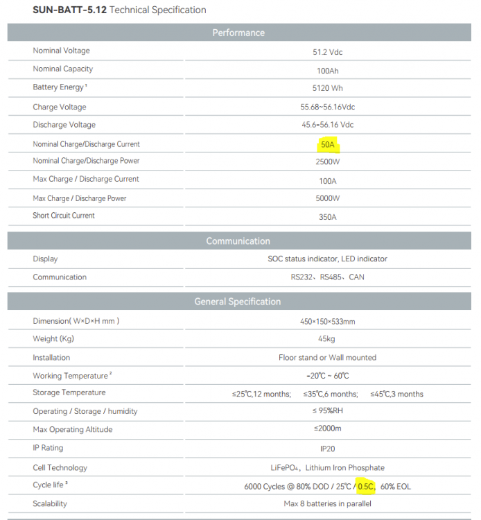

As for a condition of the extended warranty being a Sunsynk battery, it's a first that I have seen. 2 batteries are a fairly poor match for the 8k Sunsynk, because they only discharge at 50A each, so they will struggle to get over 4800W. The SUN-BATT-5.12's warranty also requires permanent Internet connectivity.

Are these batteries not 1C, i.e. 100A max continuous discharge? That is what the specs seems to indicate.
I asked Sunsynk support in Jo’brg, there seem to be two batteries floating around South Africa, one is 0.5C and the other is a 1C, but having a hard time finding spec sheets, as per Steve st Power Forum store, as far as he knows it is a 1C that they are selling ???

spec sheet for the one on the power store
I think the sslb1 is the other sunsynk battery that is a 0.5c. Which is the one I posted earlier of the product manual

Good day
Can someone that knows for sure please confirm if the new Sunsynk battery that use the BYD cells is a 0.5C or 1C battery. It states max charge/discharge current is 100A, but nowhere on any spec sheet does it state whether this is a CONTINUOUS 100A, or only for few seconds/minutes.
See picture below (button/lights on front panel). It is also near impossible to find out what the model number of this battery is. Seems there are at least 3 different Sunsynk batteries currently being sold, and the specs are all blurred between them.

These specs above is for the CATL batteries. The new batteries will use BYD.  I've contacted Synsynk directly to get some more info. The following two bits might be useful:
 - "It is a 1C battery and it can discharge 100A max, however this is the max value and the recommended is 50A."
- "The new Sunsynk batteries 1C is using BYD cells and our previous battery uses CATL cells. The older batteries is not compatible with our new batteries."
I had 2 of the new BYD Sunsynk batteries installed this week with a 8kW Sunsynk inverter because of the 10 year warranty upgrade. They also look really great. They are definitely 1C. You can see this by checking the battery info on the inverter that is being reported by the batteries over the CAN link.
