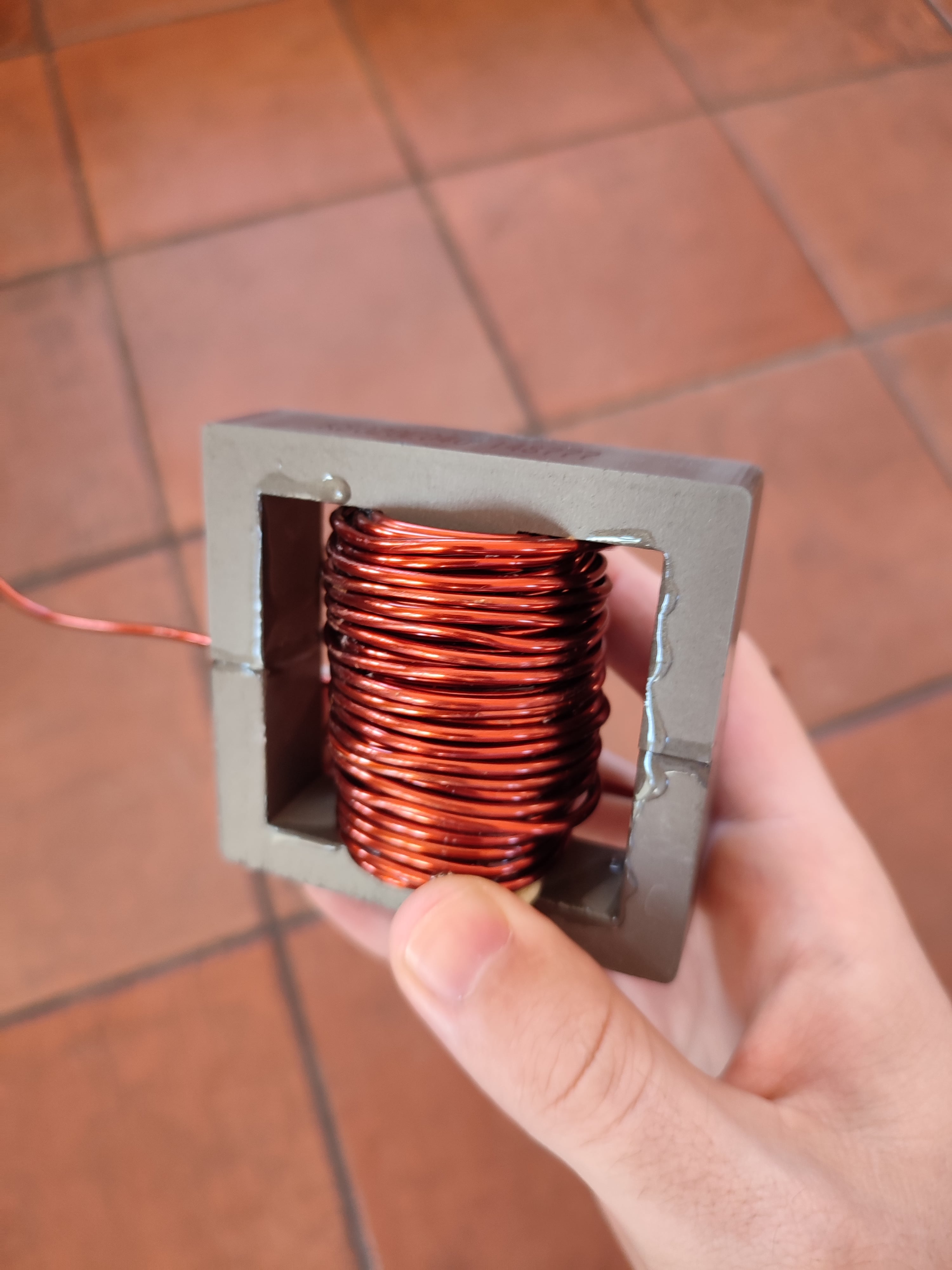

    Hi all Here is the update on how to make your own inductor to filter out the noise coming from the inverter. First off, you will need a core to wind your wire around. A toroidal core will be

Hi everyone
I have found a solution to the problem. Before you get too excited, I need to say that it isn't an easy nor cheap fix. It also only gets rid of the 15kHz whine on your appliances (output side of the inverter), while the noise from the inverter itself remains unchanged. That being said, it was still worth it for me. Our microwave was driving me insane!
Anyway without further ado, to fix the issue you need to place a big filter inductor on the live line between your inverter and your appliances. The inductor must have a ferrite core (preferably the MnZn type as they have a higher core saturation point). Iron cores wont work as they will filter out the 50Hz power as well and probably cook itself within minutes. I got my E-cores from Mantech Electronics (about R350 for two half cores), although they seldom have stock of these large cores. With these cores you will need between 50-100 turns (resulting in 1-5mH) and the wire size is determined by the amount of current your load is going to draw. I used 10m of 3.14mm^2 enamel wire (sourced from Communica @ R210) which got me about 50 turns and 1.25mH. At 1.25mH it should attenuate about 14dB of the 15kHz noise. After I installed it, I couldn't hear the whine at all. So it definitely works.
Also, another note to those who haven't wound an inductor/transformer yet, it took me a whole day to wind that thing. A solid core wire with a 2mm diameter is quite difficult to work with...
Hope this might help someone.
Regards
Wow, nice find.
Now if Sunsynk can build these and send them out to the users who are experiencing the headache inducing whine from appliances and electronics that would be great...
