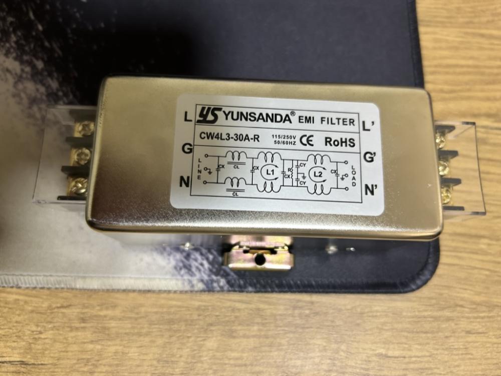

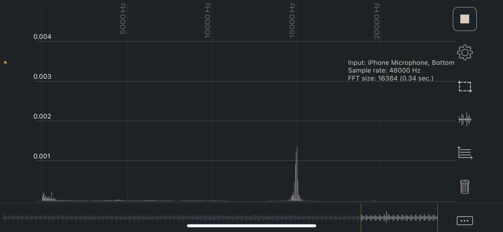

February 3, 20233 yr Thanks for the additional detail. Maybe after next payday I will try to source the components for your DIY option to at least try to filter out my PC plug noise like you did. I was only entertaining the test with their filter as I want to see where the matter turns out to go with Sunsynk and Deye, they are requesting a video showing my tests so will make one for them over the weekend and see what they say. From other users testing I knew it won't work. Didn't expect it to be worse though LOL.

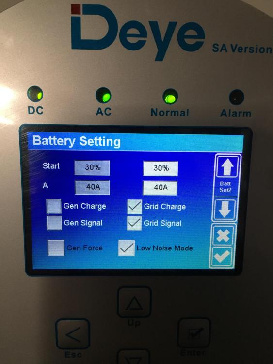

March 15, 20233 yr Great news for 5kw and I believe firmware is fixing it for 8kw users as well. Please see post here for update:

March 19, 20233 yr It was a Deye engineer that I was talking to in the mail trail who initiated the update and pushed the setting so I am sure they will.

June 13, 20233 yr 1 hour ago, DamnedDutch said: Hi all, any further info on how to solve this? @Wiggly Electron any news for an off the shelf solution? Also, could you PLEASE elaborate on your ferrite core solution above, and more importantly how to install it (lets say in front of a PC power input)? Did you ask them for the firmware upgrade that allows the new low noise setting? Works for the 5kw inverter not sure about the 8kw.

June 21, 20233 yr Huzzah!! Unbelievably GoSolr got back to me via a 3rd party engineer. He confirmed that this is an issue with the 5kw inverters. He first tinkered with some of the settings (all remote), but to no avail. He then contacted GoSolr for a remote firmware update, which took about 30 mins. The inverter rebooted automatically, and the new option was available. I ticked the box, the alarm sounded, the inverter rebooted... Booyah! Whizzz gone! Thanks to all on this group for the moral support through this dark and lonely road.... 😉
July 20, 20232 yr Author Hi All, I posted last year about an annoying 15khz high pitched sound coming out of the sunsynk inverter. This was also coming out of my appliances and was driving me mad! I wanted to report that this issue has finally been resolved by sunsynk. you need to download the latest update and then get your installer to login to your profile. They then go to “plant list” on the sunsynk platform and click “low noise mode”. your inverter will then turn off for a minute probably with an error F13 (grid mode changed). It will then turn back on and the high pitched noise will disappear. They have effectively used a low pass filter and instead of the frequency being at 15khZ, it’s now at 20kHz which is just above human hearing.
