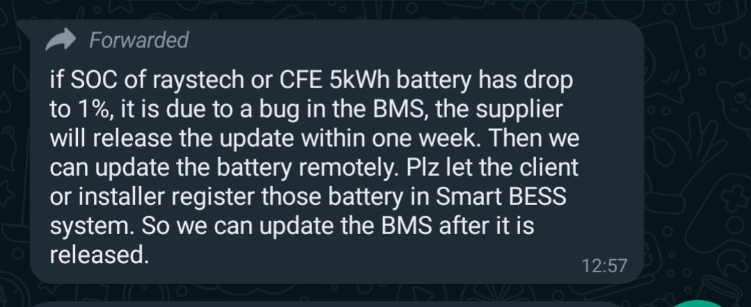

I have Raystech 5100S batteries, which are rebranded CFEs, that have BMS software problems.
Apparently CFE is aware of these issues, here's a quote from Raystech support on a specific issue related to SOC dropping to 1%
It might help others in the thread, so I'm just adding it here.
@MeepMoop thank you for sharing this... Just a question:  In normal operation does your batteries also charge up to 100% and then immediately the system drops the PV and uses battery even with PV available it then slowly drains the battery to 89% by blending a little bit of PV with Battery to supply the load and then charge it back up...  Not sure if there is going to be a BMS fix for this as well?
