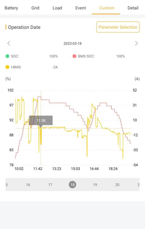

Do you have a SOC vs BMS(amps) graph for this day?

sorry but can you please send the SOC vs I-charge-limit-bms
I will also ask a friend if he could possibly help
Never knew about that stat, thanks! Shows the scenario quite well
Screenshot_2023-03-23-14-09-26-518_com.elinter_app.sunsynk-edit.thumb.jpg.e7f0057cdd002e09ddfd348f8b1078f9.jpg

To confirm the 95 bottom, charge limit stats from yesterday:
Screenshot_2023-03-24-06-16-14-039_com.elinter_app.sunsynk-edit.thumb.jpg.2212013189cc8898b1c1098ae504e27b.jpg
