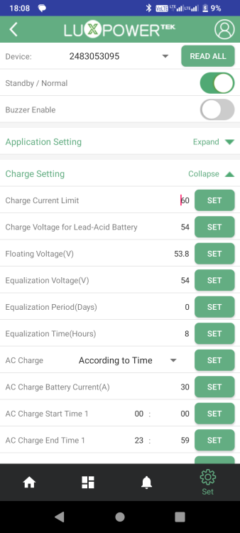

Good morning. I have an Luxpower SNA 5000 with 2 Raystech 5100s batterys. Myne also cycles between 100% and 90% then charge up again. Everything was fine my Discharge cutoff when the inverter shuts off was set to 40% and with 2 hour loadshedding never had to drain them less then about 50 - 55%. Now the first 4 hour loadshedding again the inverter switched off. Knowing cut is at 40% went to change the setting to 20% as we had 30 min left of loadshedding. Battery is showing Normal green light but on the inverter SOC was at 1% and battery voltage was at 51.7 volt. Measured with the multimeter the voltage is correct but the slave is abit lower then the master.
Also my inverter settings are as follow. Charge current limit is set at 110A inverter default from BMS, AC charge current is 30A, Discharge current limit is set to 60A. I thought that can be the problem so changed it back to inverter default of 110A. No change. I am also struggling to get the batterys connected to the Smart Bess app.
When I got home the batterys were at 100% SOC at 53.6 volts. I changed the settings on the inverter to Lead-Acid and 200A. It does not pick up that there are 2 in Parallel but SOC dropped to 85%. What should I put the charge settings at and if in Lead-acid should I remove the communication cable between inverter and batterys?
