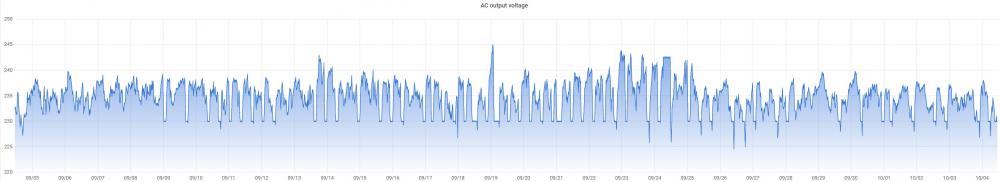

with the current loadshedding situation, I have noticed that my incoming AC voltage is bouncing around all over the place. It on a regular basis goes up to 240V and sometimes even close to 245V.
I have now installed a 'smart' 63A breaker between my incoming mains and the rest of my DB board to be able to cut my Eskom feed. During the day I have more than sufficient PV to be off-grid. So am contemplating of programming a timer on that breaker to separate myself from the grid during the day and have my inverter feed 'clean' power to my house.
Any downsides to this?
And what voltage should I set the inverter to? The standard 230V? Or something different?
