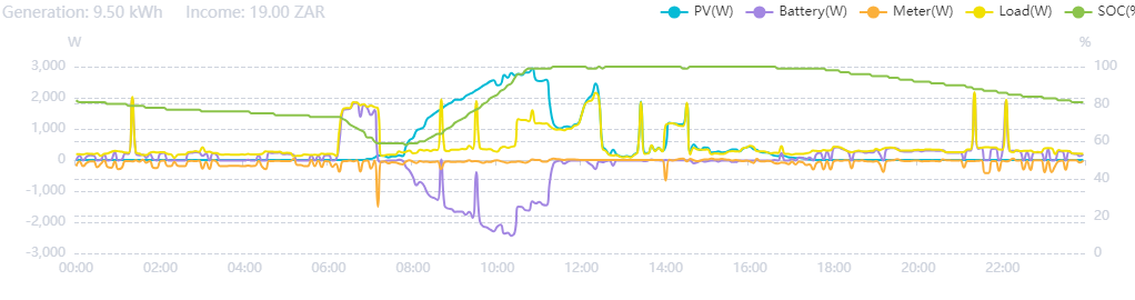

I'm not familiar with the software for your inverter, but here's an example from my system (Goodwe)
The load is the yellow line. See how it kicks upwards at about 10:30. That's the pool pump turning on. The pool pump is not on the backed up side of the system, so the demand shown here includes the backed up and non-backed up circuits. Unless the power goes out. You'll see just after 12:00 things get quiet - load shedding! Then just after 2 we see the pool pump kicking in again because load shedding is finished.
So here I see a non-backed up load effecting the graph, and so the total "load" on the graph includes non-backed up loads.
