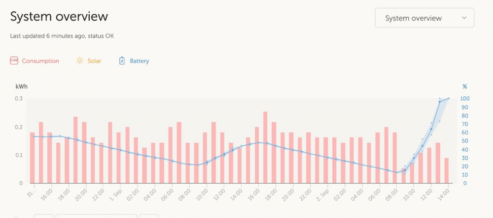

Updating this post, seeing as I'm using the batteries now in earnest.
I just splurged for the Canbus over RS485<-> to a Ve.direct usb adaptor to connect up to my "Victron" VenusPi, which means that finally my Victron can talk to the batteries and know an accurate SoC (State of Charge).  The adaptor came from Revov.  Works, but it's a bit of a crappy design.  Looking at it, I could probably have just knocked something up with an ESP32 and pumped data over wifi to the VenusPI.   Not like I don't have the time at the moment during lockdown!
Revov have told me that they're replacing their BMS in the next few months with something snazzier in future, which will be more compatible with stuff.  So YMMV..
I'll be replacing my FM80 next week with more Blue (scrounged a MPPT 150/70), just so I can see the solar pv generation, which will mean ordering another Ve.Direct cable, its been a whole week since I ordered my previous one from Jaco.
Overall I'm happy with the batteries - they work, without issues.  I think I'll be adding another 10KW of storage soon, as I'm increasing the footprint of what gets used, and I'd like about a week of battery storage if there is no sun.
Will also add some more panels on the roof soon, as the AC load is now slightly over what gets generated in winter days.
Given I've been slowly upgrading, I think I've done fairly well :)
My battery has done a whole 38 cycles since I've had it running.  I have a copy of the BMS software from the vendor which can directly query the BMS (although I do need to get an RS485 -> USB cable).  Shenzhen Tian Bang Da Polytron.
TBD_POWER BMS.  PM if you need a copy.

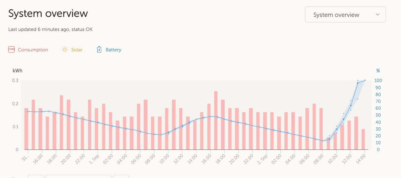

Battery SoC earlier -
