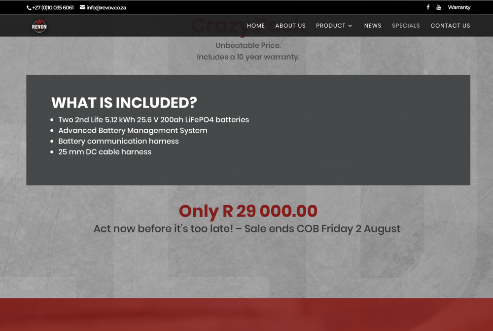

August 1, 20197 yr Revov have a special on at the moment for 10KW for R29k I know they're 2nd hand batteries, but it still seems like a heck of a price. http://revov.co.za/freedom-from-dependance/ Should I, shouldn't I...?

August 1, 20197 yr I was keen to take advantage to double up on my batteries. But my installer says he spoke to Revov and they say the advertised price is erroneous. But surely... if they advertise it, they have to stick to it? OK... all they have to say is "stock has run out".
August 1, 20197 yr 8 minutes ago, Bobster said: But my installer says he spoke to Revov and they say the advertised price is erroneous. Nope, I got the same price, been chatting with them toi see if they can give me a reason NOT to buy them. 🙂

August 1, 20197 yr Strange, saw the add. Comments from the supplier indicated 200ah for the 5.12. If you go to the site is shows 150ah battery which works out to 3.86
August 1, 20197 yr 2 hours ago, Luminous said: Strange, saw the add. Comments from the supplier indicated 200ah for the 5.12. If you go to the site is shows 150ah battery which works out to 3.86 You can check this link http://revov.co.za/2ndlife/
August 1, 20197 yr 2 hours ago, Luminous said: Strange, saw the add. Comments from the supplier indicated 200ah for the 5.12. If you go to the site is shows 150ah battery which works out to 3.86 From what I understand, could be mistaken, it is two of these batteries - 24v 200ah x 2 = 48v 200ah bank at 5.17KWh x 2 = 10.34KWh Or what am I missing? Warranty: 3500 cycles at 1 cycle per day up to 90% DOD (9.5 years) or 10 years, whichever comes first. Only 48v as they are still busy building a new 24v BMS. What a relief! 🙂

August 2, 20197 yr Author They've taken the R29000 price out from the page, although I have a copy snapshotted of it. Have a reply from them, but they didn't confirm pricing or stock yet.

August 2, 20197 yr Author I got a reply from Dawie - We have stock in Johannesburg yes, the price is valid until COB today only. From there pricing will revert back to normal. Guess i'll order a set then!

August 2, 20197 yr Author I went ahead and ordered a set. R33,350 with vat, + whatever the delivery charges are likely to be to CPT (R1500 at a guesstimate).
