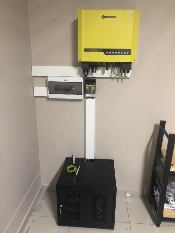

Leshen Posted September 23, 2019 Share Posted September 23, 2019 Hi Hennie. I had the Goodwe 4.6kw paired with 3 x 2.4kwh Pylontechs and 17 x 330w panels and it never skipped a beat. It ran like clockwork for 2 years till we sold the house. The only downside is the Goodwe cannot be paralleled so we had to manage how many appliances we switched on at any one time. I love the fact that it has no fan so it’s completely silent. I know many guys love Victron because of the quality. Quote Link to comment Share on other sites More sharing options...
