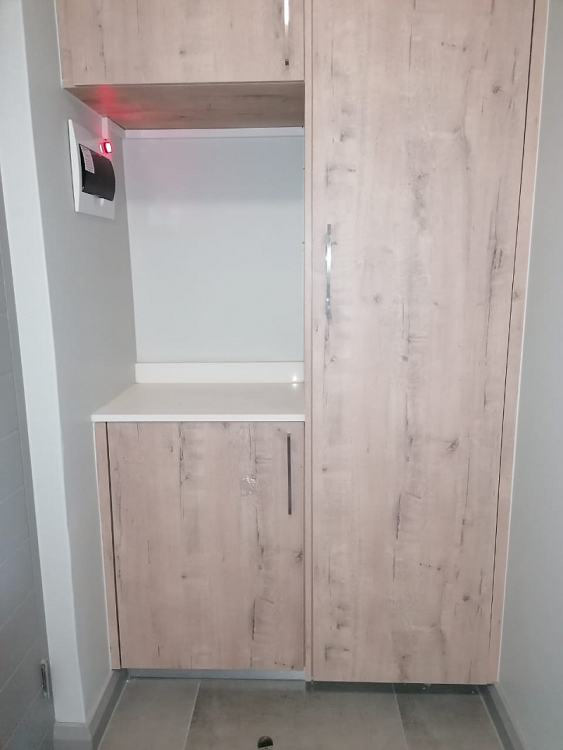

My daughter has just moved into her new apartment. In anticipation of load shedding returning, I purchased 2 x Pylon US3000Bs for an installation in the apartment. There is no way to incorporate solar as the body corporate will not allow it so we are looking at a purely UPS solution to power TV, router, laptops, lights and plug points i.e. a solution to reduce the discomfort of no electricity.
I initially wanted to use a Multiplus II 3kVA but I think it would be too noisy. I own one and it can be loud when inverting, too loud to live with in an apartment. I love and I am comfortable with Victron's suite of hardware and software so I would lean in that direction. There is a cupboard above the DB in which the Inverter could possibly be installed but I don't think it will sufficiently deaden the noise.
Any thoughts and suggestions?

Install the silent fan assistant and wire up a push button to one of the analog inputs. That keeps the fan off.
The rest remains the same: The inverter will still switch off if it overheats, and of course this will now happen a lot sooner if you make it work hard. But under low/moderate loads it's going to be fine. This feature is in fact designed for motor homes and other "close quarter" environments, so you can keep the unit quiet at night when average loads aren't going to be that high anyway.
If you need to power something on the large side, just flip the switch off 🙂

Installation done. I'm really happy with it. way quieter than expected when idling. The fan switch is located to the right of the Jean Muller battery disconnect and when engaged, makes the system completely silent.
Thank you @Jaco de Jongh for the customary wonderful service and patience. Thanks @plonkster for the ' Silence fan' assistant tip.
The problems encountered during load shedding have all been mitigated.
