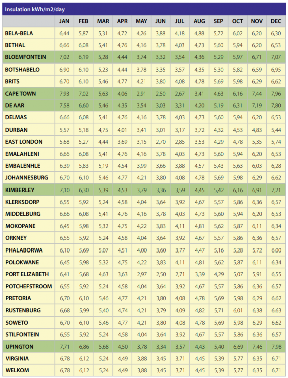

August 12, 20206 yr 7 hours ago, Blowdart18 said: I am not sure if summer will bring through much change, might reach the 5400 watts much earlier than expected. @Blowdart18 This table from geyserwise is pretty good as a reference for how much difference there is between the months. Don't mind what the actual value is in this table, just calculate the percentage relative to the best summer month, then do the math to predict what you will get in that month based on what you currently get. https://www.geyserwise.com/wp-content/uploads/2016/03/0207_PV-system-installation-manual_web.2016March09.pdf

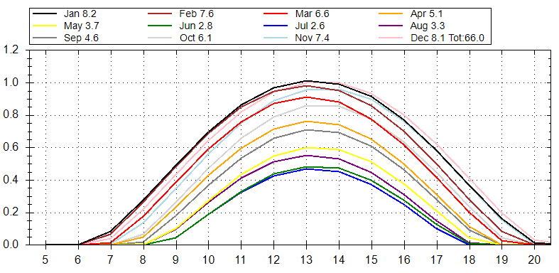

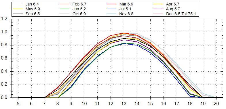

August 12, 20206 yr 1 hour ago, pierre. said: This table from geyserwise is pretty good as a reference for how much difference there is between the months One really important thing that they don't point out: This is per square metre of horizontal surface. If you tilt your panels the figures change dramatically. At about 40% from horizontal, facing North, the difference becomes very much smaller. Below the output for Stellenbosch for panels at 0%. Note how the daily output numbers are close to the Cape Town ones from Geyserwise. And here is the output at 40 degrees tilt. As you can see, at 40 degrees tilt the difference between the months is much less. Edited August 12, 20206 yr by Calvin
