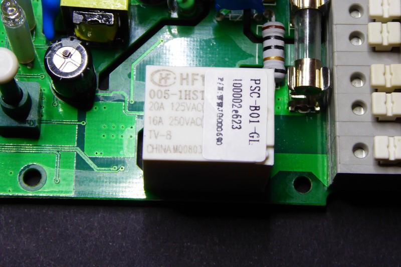

It's hard to say. It burned because something got hot, which usually means there was a high resistance somewhere in the path of the current. Normally I would expect a poor connection where the wires pushed into connectors, or the relay itself burned up (this could happen as repeated switching causes the contacts to carbon up and form a high resistance point).
As you probably know, since you referenced that it is an inductive load, induction motors needs 5 times (sometimes more) the nominal power when they start, so as much as 40A when it starts. Since the POW R2 has a 15A relay, this may well be the problem. If it is, I would expect a disassembly of the unit to confirm this: The relay should be totally melted while other pars further away may be less burnt up. Just from the picture, the terminals themselves looks fairly good, and the hole in the case seems to be right about where the relay is...
But I also see a somewhat bulky 10Ω resistor in that general area, and a fuse. It could be those too...

Well, I'm not a fire inspector and I don't know how possible it is anyway, but I would look at where it is the most melted, the most burnt, and try to see where it started. To my naked eye it seems to have started around the relay/fuse area (red arrow), that area seems more charred up than the wire connections (yellow circle). I can even see some clean copper on the blackest of those connections... which I would not expect if that part got very hot.

Maybe the 10Ω resistor doubles as a fuse.
I'm not kidding... this sort of thing is done to save a buck...
Look online, a while ago some people reviewed a Weller soldering station and went a bit ape about no fuse (like the old ones had), and Weller wasn't particularly worried... it's apparently perfectly safe to let the transformer's primary winding take the hit.
Oh yeah fair enough.  Its common practice non servicable "fuse" hehe. Nothing really too wrong with that imho. But a fuse fails reliably by contrast. My assumption earlier was that the first pows were fused? That would have been on the load side not to the power supply section. Just interesting. Im keen on testing mine, wondering what higher voltages would do to that because ive seen some horrible grid voltages here lately.
If i had to guess the failure reason its either power supply isolation fail making the supply circuit over draw or most commonly and already discussed a loose connection. I dont like the push pin terminals, thats why i use the ferrules here. Gimme screws pls

Had a sonoff running my pool pump... until the capacitor on the pool pump died... 10A relay, 15A breaker... no flames though, only killed the relay. Getting the dead relay out isn't difficult and replacing it with a big solid state relay is easy enough... makes the wiring a bit weird but it takes the sonoff out of the path of the current so probably the safer way round. (Also the bigger SSRs have a metal back for a heat sink... if you're really worried)

Yeh I think you are right my pow r2 just stop working and when I open it mine is also without fuse but I see that risistance is totally burned out .
Can you do me a favour I want to know the value and type of that risistance so I can easily buy from the market.
