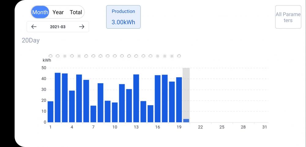

Tariq Posted March 20, 2021 Share Posted March 20, 2021 Tells you that a lot of installers don't know what they are talking about, just the other day I was doing 7.52 kW's on a 5 kW Sunsynk, the 5 kW was coming from the inverter and the balance of 2.52 kW was being supplemented by the grid, and it probably was an easy 30 plus minutes, till the geyser and tumble dryer shut off Frost and Achmat 2 Quote Link to comment Share on other sites More sharing options...
Achmat Posted March 20, 2021 Share Posted March 20, 2021 8 minutes ago, Frost said: I have had two installers now that argue with me that it is not possible to supplement form the grid if you go over the max of the inverter, they say it switches over to bypass mode completely and only use grid power. They say It can do so for a few seconds for startup load but not for continuous use. Apparently it’s not good for the inverter to run at close to the max for long periods of time. Wow that power production is great ist 41kw average per day over 231 days, on complete cloudy and rainy days do you still produce power if so, how much of your daily average to you get? Every installer I've found know very little about the capabilities of the sunsynk. I decided to find a sparky and told him how I wanted the unit installed and basically project managed him during the install. It's a hybrid so it will blend from the grid even if you go over the 8kw of the inverter. I have witnessed this first hand with screenshots in another thread. It still produces pv on cloudy it rainy days but very little. The lowest I think was the about 12kwh. Current month daily PV generation for Somerset West, Cape Town. Pumba and Frost 1 1 Quote Link to comment Share on other sites More sharing options...
Frost Posted March 20, 2021 Author Share Posted March 20, 2021 Still looks great, do you use some eskom power during the days that power production is lower? Say i do go for the 2 x 5kw inverters to future proof is there any disadvantages in a parallel hybrid system, do they still share the pv inlet and batteries ? Quote Link to comment Share on other sites More sharing options...
