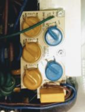

Still I very, very highly recommend you buy a Surge Protector to also protect the Inverter supply.  The King does have internal surge protection MOVs but they are clamping devices that have a limited life.  So if you can wear out an external surge protector first to take most of the brunt then it'll be the wiser decision IMO.
Surge protector board in the Axpert King:
