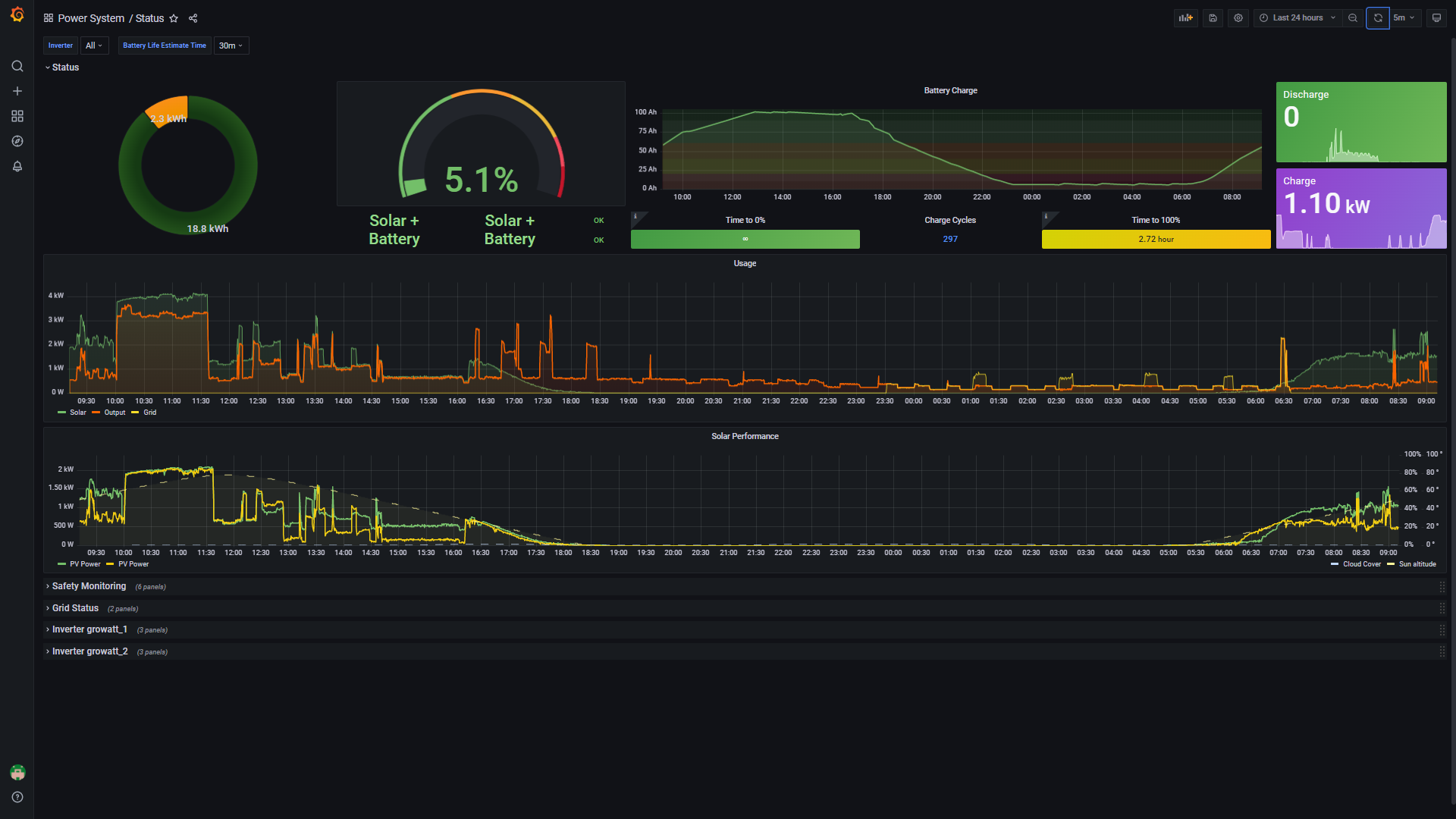

@87 Dream I'm still struggling to understand the concept of DOD and I want to make sure I am not stressing my battery, in other words not shortening it's life span
I make use of the battery every day from fully charged to discharge level of 48 V as per OEM.
Battery is a 100 AH, 51.2 V, 5.1 KWH SA Lithium, we usually discharge the battery from fully charged  at about 16:00 to 48 V at about 23:00, by then my system switches over to mains and keeps the battery at that level using a bit of power from mains.
OEM recommends max charging current  50 Amps, I do it at 20 Amps, not in a rush to charge the battery.
See screen shot of the last 24 hours.
I'm I doing something wrong ? please your expert advise will be highly appreciated.
Edited by Antonio de Sa
to add more info.

@87 Dream Thank you very much for the explanation, really appreciated, I've changed the setting on my inverters, I will keep an eye on the results. will give you feed back
soon. I'm not running the system on a BMS that is why I monitor the results on my monitoring system ( designed by my son ) and that way I can see all the parameters that really matter. I will follow your recommendation of once a month taking the battery to full voltage charge.

Yes, without BMS, if I connect the BMS  overrides the setting on the Growatt inverters and charges at 50 Amps, I don't want that
Did you build the pack yourself using individual cells or is it the 5.1kWh prebuild pack as supplied by LBSA?
The battery is a standard LBSA 5.1 KWh battery
Great that your son has these skills. These are the skills we need in this Solar Game. Because these battery manufacturers unfortunately make a system sell it us then change that system & then revoke support for that system leaving us at a Dead end. You cant upgrade without spending & then your last product is not compatible.
Struggle a bit to get the PI  to connect to the battery but eventually we got it working.
With my monitoring system I can retrieve and display every single parameter, both from the inverter as well as the battery, this information is archived in our home server in case there are future guaranty claim issues
If we get more understanding, access to cells & ppl that can integrate systems we become more self reliant & independent of a big name.
That would be the ideal world, but one has to accept that lots of money goes in R&D and we unfortunately pay for it, including the clones that spent nothing and push they products down our throats
Screen shot of my daily consumption/production, my system it's new just about a month old
87
to add more info.
