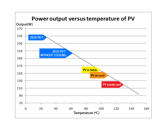

Chris-R Posted January 19, 2017 Share Posted January 19, 2017 Chris, excessive heat on the panels and cold water in your geyser? Would be nice if someone can get a way to extract heat from the panels and put this into the water in some or other way? Quote Link to comment Share on other sites More sharing options...
Neo Posted January 19, 2017 Share Posted January 19, 2017 The panels exist, they are called hybrid or PV-T for PhotoVoltaic -Thermal. Quick google graphic for claimed performance.. Quote Link to comment Share on other sites More sharing options...
