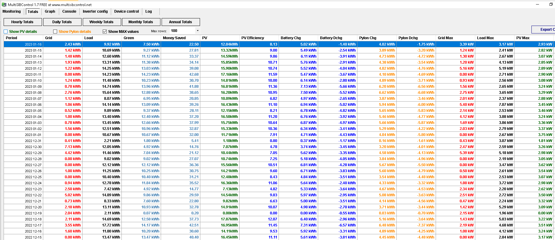

Hi,
Just as a side note, I have diffirent size panels connecting to one inverter so I can give you an idea of what my generation is.
Setup:
1x Kodak OG 5.48 inverter
3x 370w strings of 2 panels in each string
1x 450w string of 2 panels each
On avergate I generate around 15Kwh per day depending on my load with peak generation averaging around 2.9KW and peaking over 3KW quite often on good days.
I can share more stats if interested?
Not sure if this corrolates with the calculations done above, just thought it might help.
1 hour ago, WernerM said:
Hi,
Setup:
what monitoring tool are u using  ?
multisibcontrol.net
I found this tool on the powerforum and its a life saver for the older inverters that dont yet monitor the actual battery SOC.
http://www.multisibcontrol.net/Default.aspx
Let me know if you need any help with the config should you want to start using the app.
