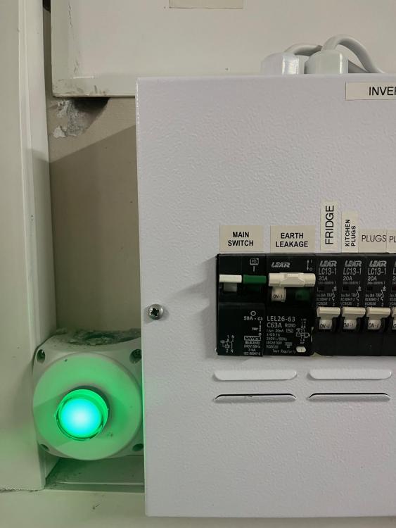

Can you please elaborate more on the Light in DB box?
What my installer explained that this is according to some regulation (don't know exactly which one). It is to indicate to the fire department that this DB board (and hence part of the house) is still under power even after they have cut the Eskom main power feed (assuming that the inverters are still running)
Mine looks like this:
