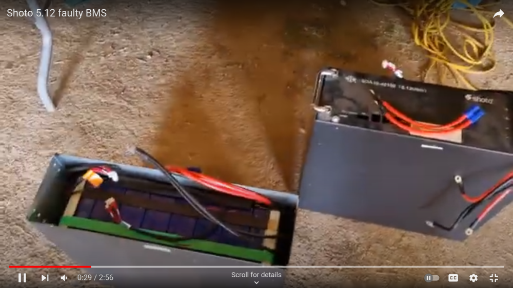

April 9, 20233 yr On 2023/03/07 at 1:28 PM, jumper said: the inside of the shoto batteries According to this YouTube video, Shoto SDA10-48100 51.2Vdc 5.12kWh batteries use prismatic cells. Screenshots attached.
