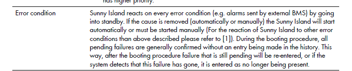

4 hours ago, hoohloc said:
The BMS is not supposed to turn the inverter off, it has nothing to do with the inverter. You got it very wrong here. The BMS is supposed to shut the battery off, not the inverter
No, sorry, it's  you who are incorrect, look at the pylontech protocol. The protocol will send error codes for the inverter to react to. That's on top of the actual normal instructions that it sends to the inverter. eg.  by limiting the currents. (0X351 bytes, 2,3,4,5)
(That's if you have a decent inverter. I am using inverters that are over 12 years old that have no problem with Pylontech batteries. That's because they were designed properly and are a quality inverter).
It blatantly obvious that the inverts in this thread can't control the voltage correctly and that's not Pylontechs problem. They say the inverter should be approved and their is a reason for that.
