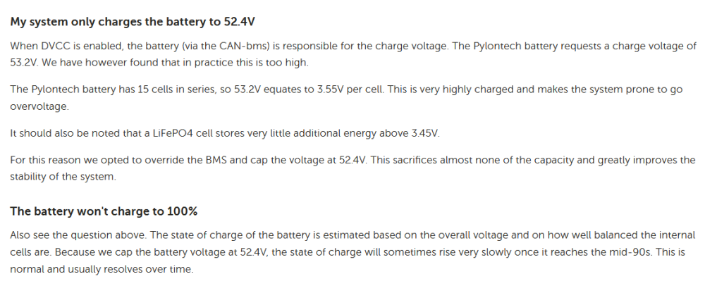

June 14, 20233 yr 19 hours ago, Tinbum said: . (Victron limit their inverters to 52.4 or 52.5v (can't remember which)). That's only because of their topology and not being able to regulate fast enough, so they just lowered it until they stopped getting high voltage alarms. If you have an inverter with a decent control loop, you won't have that issue. 53.2V is 3.5466V per cell, which is not at all a problem for LiFePO4.
June 14, 20233 yr 4 hours ago, FixAMess said: yes, every single battery has over voltage errors logged. Usually when one introduces a new battery to the bank it takes a few cycles to settle down, irrespective of whether or not all the batteries are charged to 100% then left overnight to equalise etc. The point is, I have taken care not to wreck the batteries but there are still issues logged. Yes, but I guess they are cell overvoltage errors and not battery pack overvoltage errors. Their is a big difference. Edited June 14, 20233 yr by Tinbum
June 14, 20233 yr 3 hours ago, P1000 said: That's only because of their topology and not being able to regulate fast enough, so they just lowered it until they stopped getting high voltage alarms. If you have an inverter with a decent control loop, you won't have that issue. 53.2V is 3.5466V per cell, which is not at all a problem for LiFePO4. Really, Vicron say that. Many would disagree with taking the voltage that high, their is little point and it's always best to leave a margin.
June 14, 20233 yr 39 minutes ago, Tinbum said: Really, Vicron say that. Many would disagree with taking the voltage that high, their is little point and it's always best to leave a margin. Who are the many that disagree? If you make a list of batteries on the market and what they charge their cells to, you'll see that is on the lower end.
June 14, 20233 yr 24 minutes ago, P1000 said: Who are the many that disagree? If you make a list of batteries on the market and what they charge their cells to, you'll see that is on the lower end. Its been mentioned on this forum and another that i am a member of many times. You only have to look at the charge curve to see. Edited June 14, 20233 yr by Tinbum

June 15, 20233 yr 19 hours ago, Tinbum said: Its been mentioned on this forum and another that i am a member of many times. You only have to look at the charge curve to see. It seems to me that it's been mentioned a bunch of times, but only by you. The charge curve does not really provide much insight into why you would choose a lower voltage. It all depends on what the chemistry does when you do go over this voltage, and in the case of LiFePO, the answer is not much (up to around 3.65V).
June 15, 20233 yr 4 hours ago, P1000 said: It seems to me that it's been mentioned a bunch of times, but only by you. The charge curve does not really provide much insight into why you would choose a lower voltage. It all depends on what the chemistry does when you do go over this voltage, and in the case of LiFePO, the answer is not much (up to around 3.65V). The charge curve shows it all. Their is very little point taking the voltage that high as you gain very very little extra capacity. Some examples, https://powerforum.co.za/topic/19327-best-practice-for-charging-litium-battery/#comment-168095 https://powerforum.co.za/topic/6807-guidance-requested-on-shoto-sda10-48100l5-battery-settings/#comment-154152 From the Victron web site. Seplos BMS settings for their packs. Edited June 15, 20233 yr by Tinbum
June 15, 20233 yr 1 hour ago, Tinbum said: The charge curve shows it all. Their is very little point taking the voltage that high as you gain very very little extra capacity. Some examples, https://powerforum.co.za/topic/19327-best-practice-for-charging-litium-battery/#comment-168095 https://powerforum.co.za/topic/6807-guidance-requested-on-shoto-sda10-48100l5-battery-settings/#comment-154152 From the Victron web site. Seplos BMS settings for their packs. Your victron link says exactly what I did - they get overvoltage alarms on victron equipment, but they won't on equipment with a fast enough control loop. The snippet from seplos does not really say anything at all - just their standard settings. While it is true that there is very little extra energy stored by going higher voltages, it has no detrimental effects to the cells - and might be needed to balance the cells, depending on the BMS config.
June 15, 20233 yr Victron equipment has a reputation for being good and of a high quality as does the SMA equipment I use. They have been around for years and are specialists in their field unlike a lot of the manufactures that are around now. I would take their advise on settings. Yes the cells are designed for a max voltage but it doesn't mean that you have to take them to that voltage. A BMS that requires them to go to that voltage to balance should be put straight in a dustbin. Their is no benefit of taking them to max voltage and allowing a margin is good practice and advisable. Any system, be it quality or rubbish, is going to find it hard to control voltage spikes when large loads are suddenly turned off. I dont believe for one minute that Victron have a problem with their control loop- your making assumptions.
