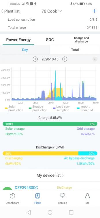

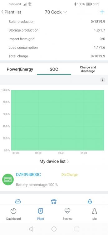

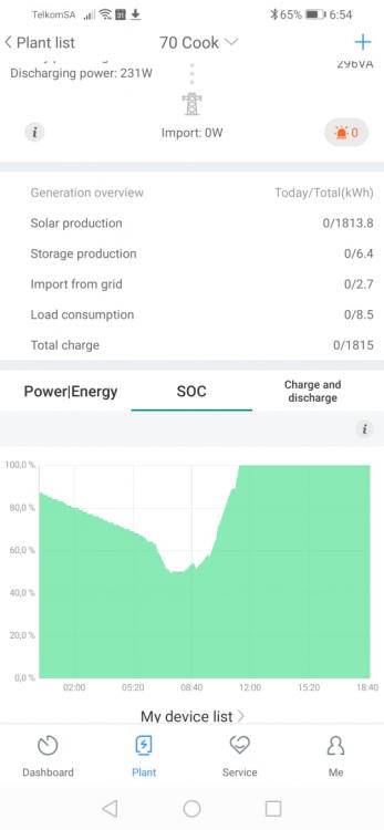

I have a long running attempt to understand the relationship between my Pylontech BMS and the inverter settings. I have 2 x Pylontech US3000, the HVM inverter and 3.2 kW of panels.
In the morning, particularly here in CT in winter, batteries get to to 22% DOD and from that point on, regardless of available panel charge, the BMS/Inverter will draw only 1650W until my lowest possible SOC of 60% is reached. At this point, suddenly the panels are then able to contribute to domestic load (see attached graphic). No attempt at changing settings is possible, beyond no. 12 being 22% and 13 being 60%.
This particular event makes me circumspect about getting a third battery, as the charging time will become even longer should the DOD be reached.
I am always able to get to full charge somewhere in the day (except on the darkest rainy day in the Cape) so this 'panel hijack' is deeply frustrating.
Thoughts much appreciated.

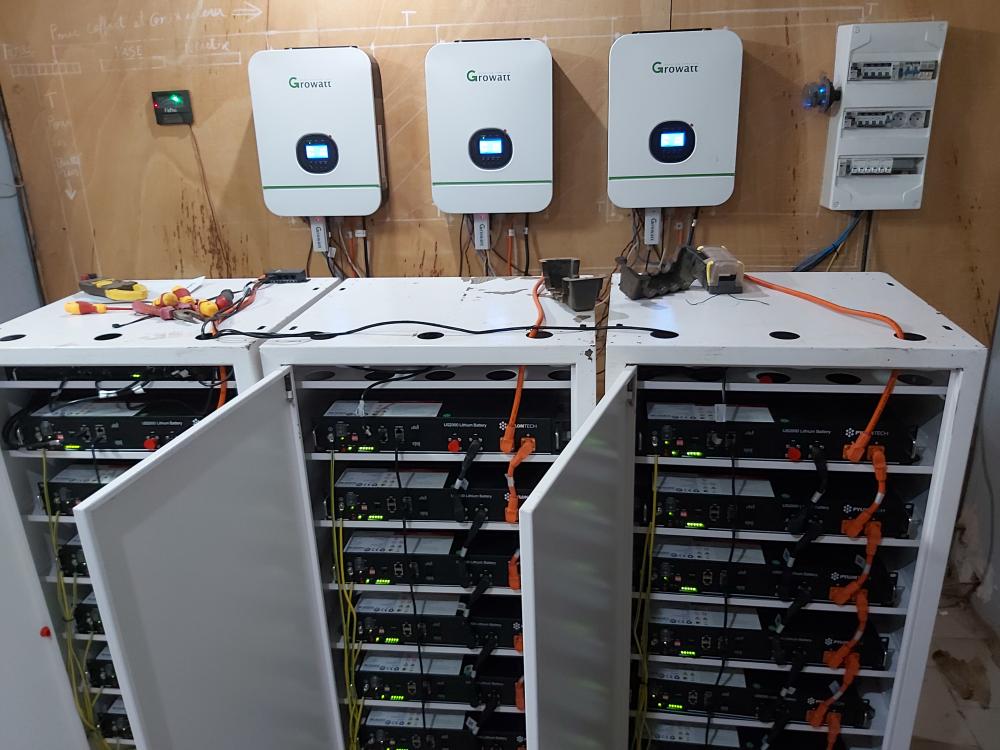

Hello everyone, I also have the same problems with my three SPF5000 growatt in parallel and three groups of pylontech batteries connected using the pylontech LV-HUB and the rs485 / can growatt HUB to gather the communication from the inverters to the LV  -HUB.  my problem is that with my three groups of 18 pylontech batteries, the inverter only displays 8a.  I am forced to enter them from ur USER to be able to charge the batteries.  but with the parameters USERle the base displayed permanently 100%.  If anyone has been able to find a solution I ask for enough help.  I am in contact with my supplier in china and growatt but no solution on the horizon.  thank you

Hello dear, I also have similar problems with my three SPF5000 growatt in parallel and three groups of connected pylontech batteries, using the pylontech LV-HUB and the growatt rs485 / CAN HUB, to gather the communication from the inverters to the  LV -HUB.  my problem is that with my three groups of 18 pylontech batteries, the inverter only displays 8A while I have a power of 14kw of solar panels.  I have to put on USER to be able to charge the batteries.  but with the USER parameters the SOC permanently displays 100%.  I ask for help too.  I am in contact with my supplier in china and growatt but no solution on the horizon.  not sure if i need to update firmware as well, inverters show aversion 500.06 / 002/00 / null.  thank you
Hi, update your firmware, my inverters have 500.07/002.03/null. Not sure if this is the latest firmware but it seems to be working. There must be something I was missing when running two in parallel. But since one blew, I got a chance to see how one performs individually. I suspect the issue is the splitting of BMS communication between the inverters. I just use a normal network spliter, the cheap one bought from RS components. With all four batteries bms comms connected to one inverter, I can now get up to 80A charging and that is limited by my PV capacity. Increasing my PV should increase that current
Hello,
I look forward to you then.  As for me, I tried with only one inverter running, the load current was at 25a but once the other two inverters were on, this current is shared and becomes 8a and per inverter.  everything suggests that inverters only communicate with a single battery.  i did the last software update to 500.09 / 02.03.null but it's still the same.  I have doubts if the network crossover cables I am using are suitable.
happy new year 2021.
21 minutes ago, Bafaro69 said:
Hello,
I honestly believe that our issue lies with the spliter or maybe we are not supposed to parallel the battery wiring on the inverter. will test when I get my inverter back. Maybe each inverter needs to have its own batteries like it has own PV. The 80A charging current i got when it was partly cloudy and still believe I can get more when its sunny. i just need to keep testing
It seems perfect with a single inverter anyway for you.  we keep looking.  I have to change the rj45 on the LV-HUB side, it is not identical to that of the battery and the inverter.
