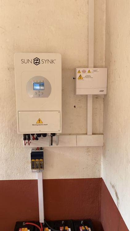

My installer did the same, as per Sunsynk manual.

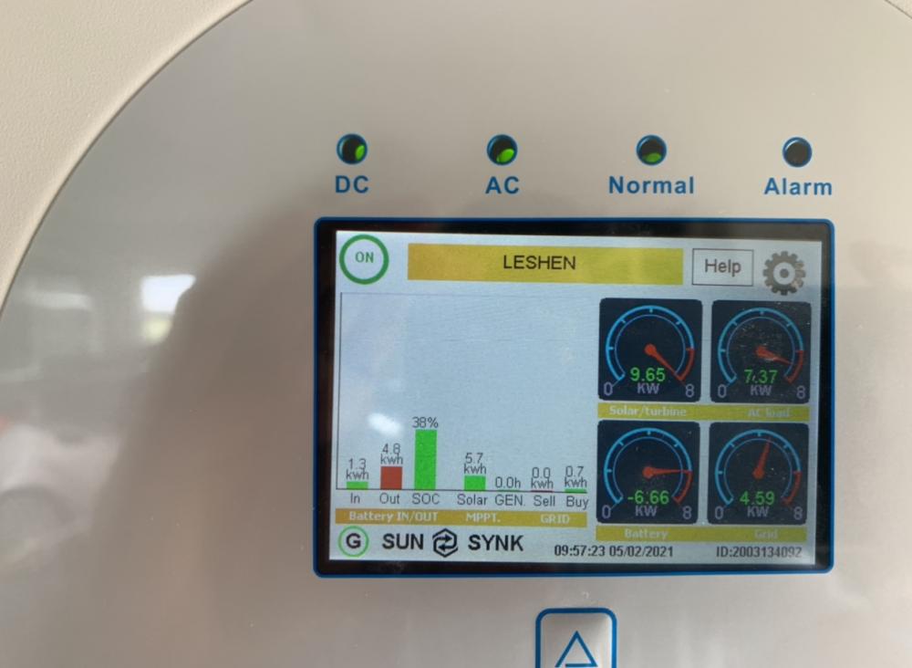

  • For those of you who doubt the Sunsynk 8.8kw inverter, here are some figures of what I produced today.  This outclasses Victron by far!

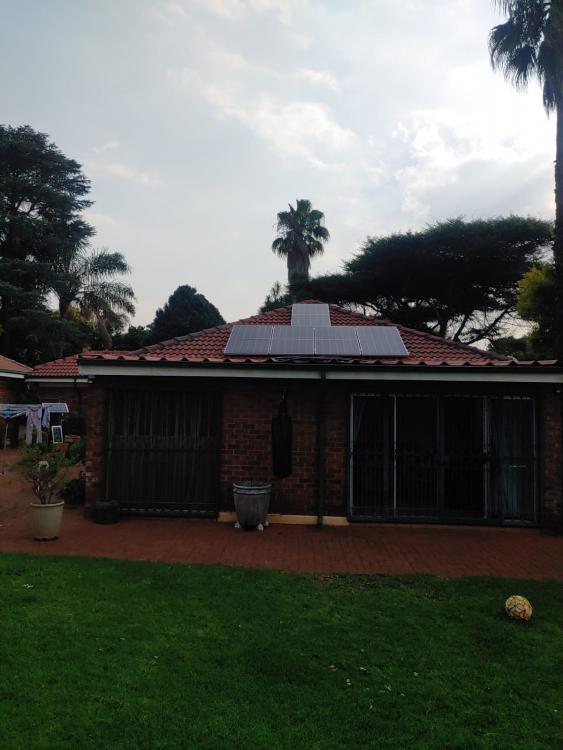

  • We installed a Klip Lok roof. So the panels are mounted in a landscape orientation without a rail. Much easier and cheaper.

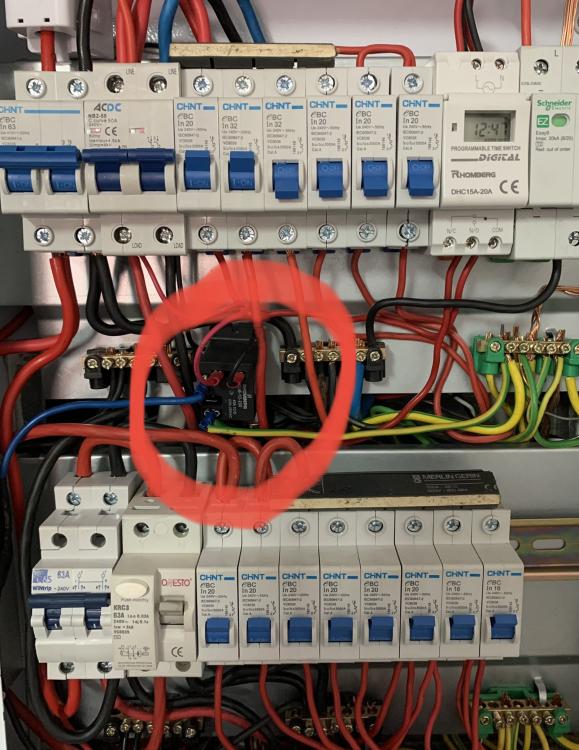

On 2021/01/15 at 2:34 PM, Vassen said:
Hi Imraan
There seems to be some confusion with some of the suppliers saying it’s not needed and even some users saying they don’t have it installed. however, sunsynk training manuals and videos say that it’s needed.
it’s basically just a 220v relay with a 220v coil, that is used to connect the earth and the neutral together when the inverter is running without grid. Under normal operation, earth and neutral is bonded by the municipality/ eskom but when the grid is down, this bond is no longer there. So you end up with what is called the floating neutral which is why your plugs may be giving you errors.
You can get the relay from AC/DC or other electrical shops. The AC/DC one is around R80.  Whether you can install yourself or not depends on your capabilities  and experience working on 220v.
what you need to do is connect the coil of the relay to the ats240 pins on the inverter. Then the common terminal of relay can go to earth and the normally open terminal to the neutral on the LOAD SIDE of the inverter.
If you are not comfortable, get the installer or electrician to install. The 8kw unit has enough space inside to install. I have the 5kw and installed it in the essential loads dB.
Just an update. The installer came out and installed an earth bond relay to solve the problem as you suggested. He tried installing first on the inverter, but it did not work and eventually installed it directly on the DB. The relay is not connected to any of the ATS 240 pins on the inverter. Since then with the load shedding over the weekend, the system works perfectly with no issues with the plugs. It seems that the earthing issue has been solved. I must indicate that when the grid goes out, it takes approximately a minute when the relay kicks in to provide the earth. I’m not sure if this is normal, maybe you can confirm.

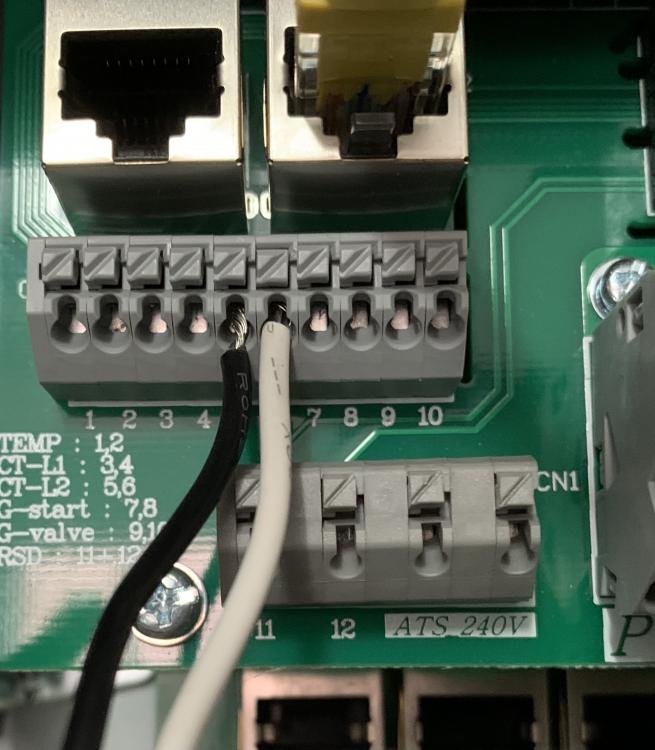

17 hours ago, Vassen said:
Hi. Glad that you are sorted. Just wondering if you are not using the ats240 then how is it connected. What’s controlling the coil.
when using here ats240, you need to configure the id landing mode on the GUI as well
the 1 minute is is normal as the inverter takes a minute to wait for the grid to stabilize being switching over
Hi. Now that you mention it, I believe the installer did not tick the island mode when he initially tried to install the earth bond relay which did not work as intended. From the pictures attached, you can see that there is nothing connected to the ATS 240. On  the other picture, he seems to have connected it directly to the db switch powering the inverter (you can see the thin red and black wires from the relay going to the switch & the blue + yellow wire going to the board). Hope the above makes sense.
