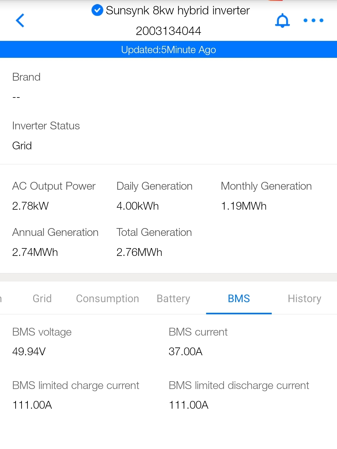

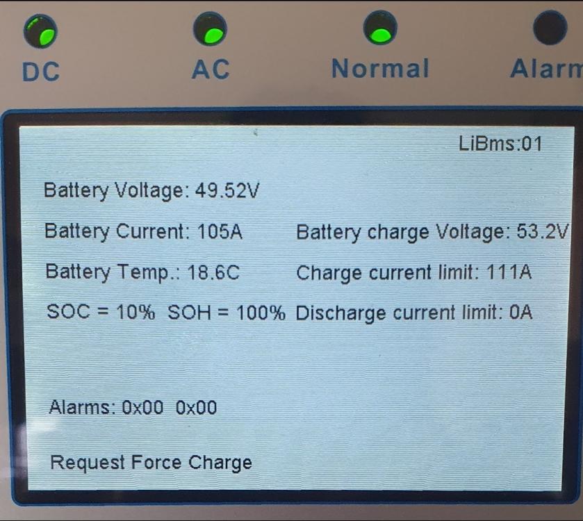

In summer have my 12000btu inverter aircon in my bedroom running whole night.
Also have a garden cottage with tenants running from the system as well.
The BMS talks to the sunsynk and manages the inverter. It sets the max and min charging and discharging rates depending on the SOC.
My sunsynk is set to never charge from grid but once the the battery went to 9% SOC. The BMS sent a force charge instruction inverter which overrode the inverter settings and it charged to 15% SOC from the grid. The inverter also looks up the state of health of the battery bank.
