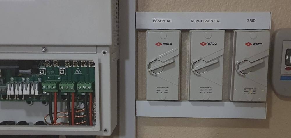

This is what I've done.
DB is split in two, essential and non essential loads.
The second ac output can either supply the non essential loads or it can be used as an ac input for a generator.
The grid input is also an output that can supply loads before the inverter.
If you have a generator and want to keep it you will connect it to the second ac output and set in software as the gen input.
Essential loads will be on the AC output and everything else can be before the inverter.
Your layout looks really neat.
What are the Waco switches used for.  I can read the printing but are they for switching between the mains and the inverter?
The switches are to disconnect the grid from the inverter (right), middle to disconnect the non essential loads from the inverter and left to disconnect the essential load from the inverter.
I have a change over switch in my DB to select grid or inverter for all loads.
Basically if I ever need to remove the inverter I would just switch the change over switch on the DB over to grid then switch off the grid Waco switch. The inverter should then have no supply coming in from the grid side.
@Achmat are you sure this safe as there is no mechanical interlocking involved?

Correct. I think I got the steps confused.
To isolate the inverter I would first switch off all the Waco switches, then switch the change over switch to grid so that my loads are back on the grid supply, then switch off DC input from solar panels and lastly turn off and disconnect the batteries. The inverter should then not receive any power and be switched off.
I do not have a generator but my understanding is that the generator would be connected to the second ac output or aux connection. This is currently my non essential loads. I have no loads before the inverter. This aux output can be configured on the inverter settings as an output or input for a generator or even another inverter input as ac coupled.

The problem is that it is not mistake-proof. If the switching is not done in the right way you will damage the inverter. Thats why I mentioned the mechanical interlock - it must be a break then make mechanism. Lately I just trip the mains isolator as the inverter will kick in in ms. My db is also split into a low and high amps side.
Thats why I mentioned initially that it will become complex - and I don’t see a way out of it. As it is my wife complains that it becomes too difficult to remember all the steps when switching back and forth - as is my habit when the highveld lightning becomes too intense to my liking.
I have a Hager SFT240 changeover switch on my essential loads, this a three way break before make switch, so there is no way to screw up, also, I have a two pole circuit breaker between the grid and the inverter. This way, the inverter can be fully isolated from the grid for repair work.
 Also, the changeover switch is a legal requirement by CoCT

After reading and spending a lot of time on the bypass switch for two inverter outlets I’ve come to the conclusion is that its best to use the essential outlet only. I am not convinced of the advantages of using the gen input as an aux outlet. In my case the electrical supply can go off for 4 days at a time and then I won’t have power to my high amp side.
Currently I can do the bypass switching and use the generator as an alternative power supply. And my better half is used to operating like this 😀
And no changes means no unnessary expenses.
Remember the grid connection on the inverter is an output AND at the same time an input, current flows both directions and this connection is for your non essential loads
