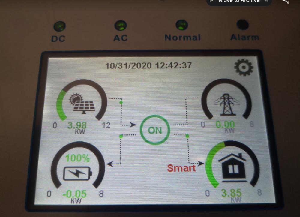

  • For those of you who doubt the Sunsynk 8.8kw inverter, here are some figures of what I produced today.  This outclasses Victron by far!

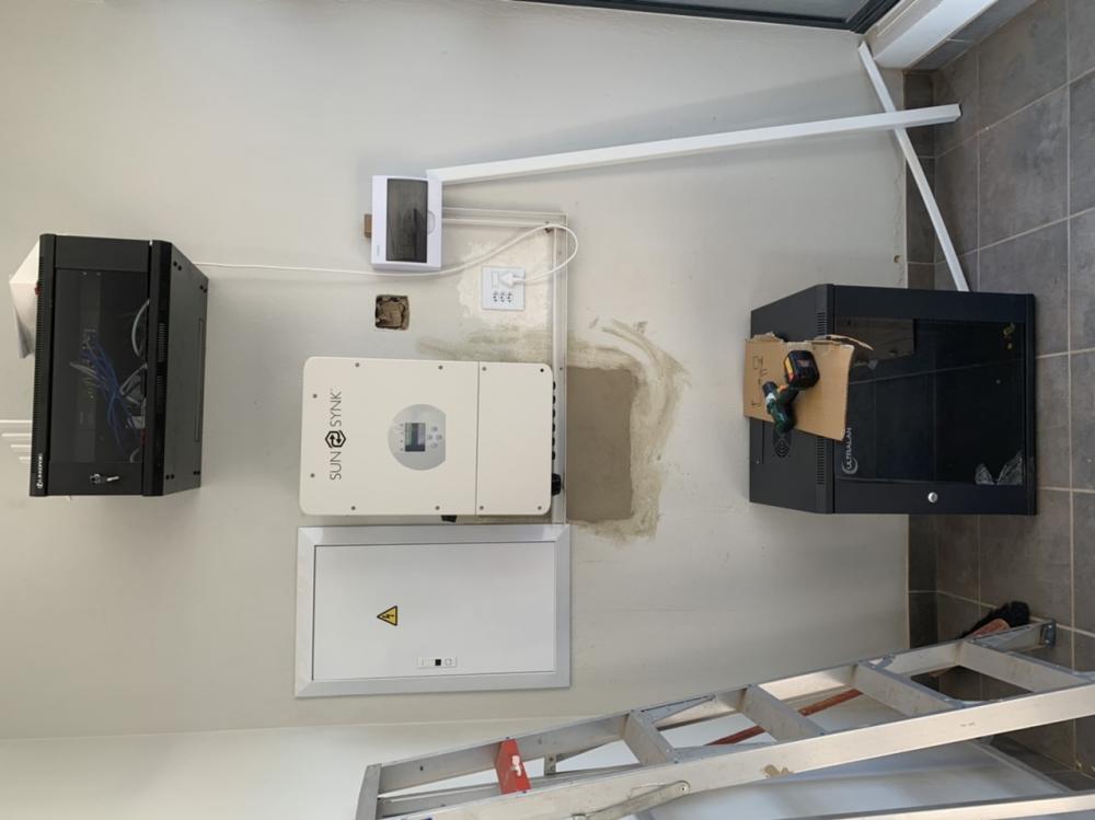

  • Thank you. Doing the last bit of the installation today.
Just now, Leshen said:
Hi Guys. My new installation. 24 x 390w JA Mono solar panels with an 8kw Sunsynk inverter and 2 x 5kwh Bull Lithium batteries.  More pics to follow soon...
We installed a Klip Lok roof. So the panels are mounted in a landscape orientation without a rail. Much easier and cheaper.

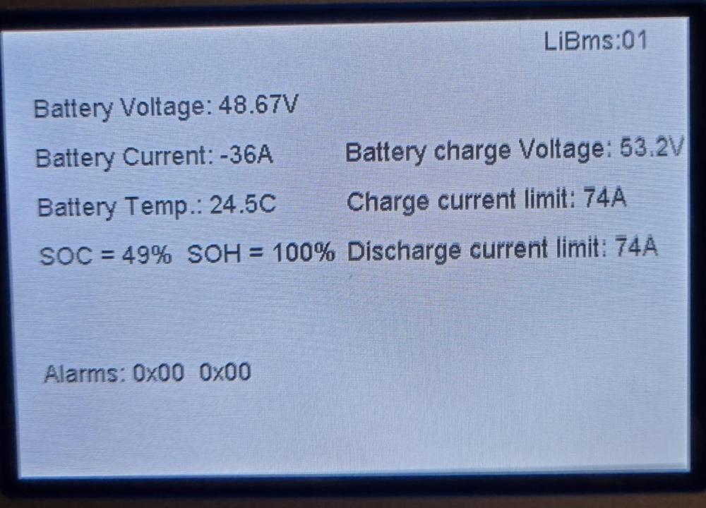

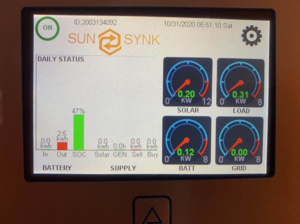

Battery at 47% SOC this morning with normal use.
Nice.
You should request the new software. That looks like an older software version.

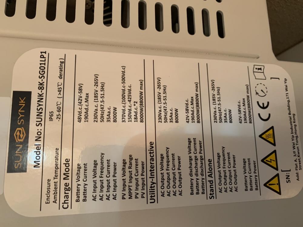

How do I get the new software. I’m still waiting for my WiFi dongle to be delivered. Also the label on the side of the inverter says PV input of 8000w yet the manual says 10000w. Not sure which is correct

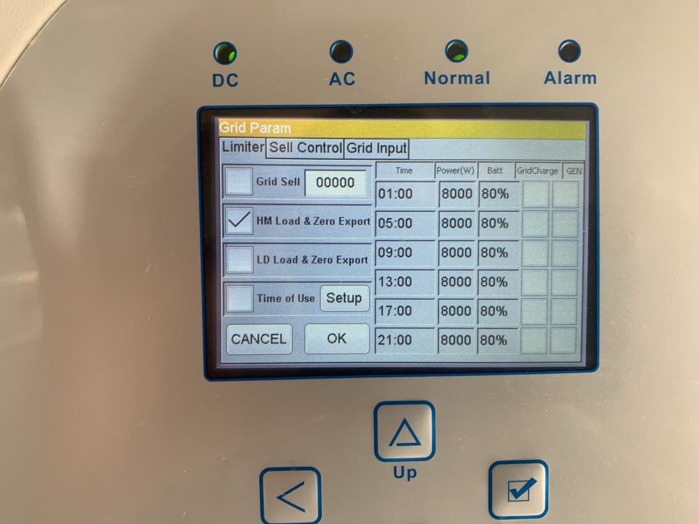

Can anyone please help me. I’m not sure it’s a software issue. My inverter prioritizes the grid instead of the battery at night. It’s only when I turn the grid supply to the inverter off, then only does it use battery power. How do I change this.
Label is outdated. I have the same unit and confirmed with support that you can connect just over 10kw of panels.

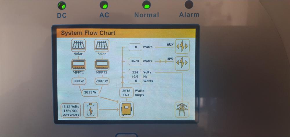

It will give you another screen like below.

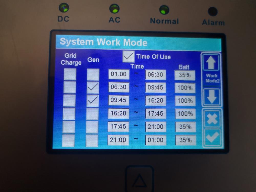

Can you post some pic of the timer settings.
This is such a better way of seeing the flow
3 minutes ago, Leshen said:
Is this it?
Yes.
You need to put a tick in use timer.
Then you can edit the times on the right and the SOC that you want to stop using the batteries.
So if you only want to use 60% of the batteries then you set the SOC to 40%. Don't tick grid charge as that is only if you want to charge from the grid at that time and when you want it to stop charging from the grid.
Ok let me try
@Vassen I had a WhatsApp video call with him and can't seem to figure out what the issue is. Could just be a software update that will fix it.
Basically when timer settings is activated its not pulling anything from solar. He has to switch the grid off to get it to use Solar and batteries.

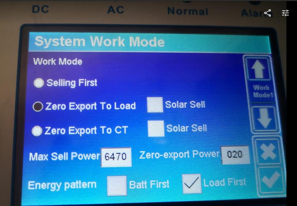

Hi there,
I figured out if you set your max sell power to whatever your solar array is then you get the result you are looking for.
I've spent hours myself trying to figure this out and that did it.
Let me know if this works for you.
This is for my Deye inverter so you'll have to find the Sunsynk equivalent.
