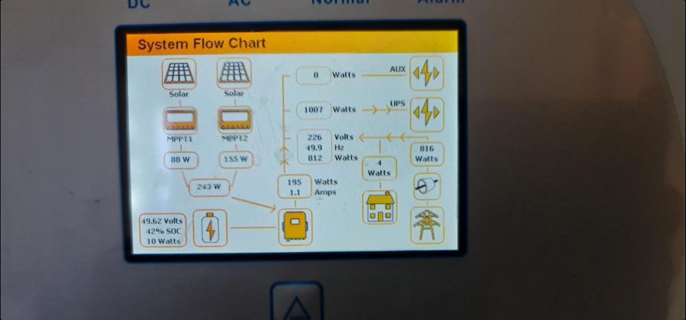

okay, so I changed the timer settings to the below, the last line being 19:20 with 50% SoC and watched the inverter's clock change over to 19:20 but it didn't start using the batteries to power the load...
you can see in the flowchart shows that it's not using the batteries but the values don't add up.
PV is zero (correct as the sun is down) but the reading at the CT shows 56W but the "UPS" (inverter load) is 1061W which would've been about correct.
So where is it getting the power to supply the "UPS" load? I have a digital amp meter on the line from the grid supply to the inverter and it was showing 4.7A which is about correct for the load of 1102W at 228V.

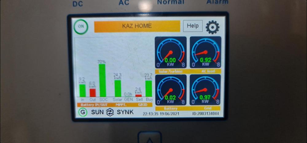

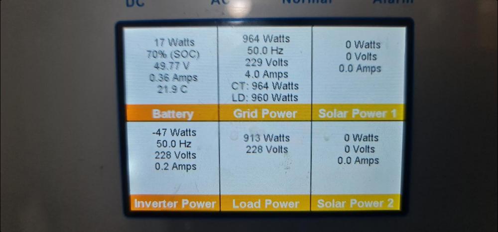

1 hour ago, RhysMcW said:
here are pics from this evening
I still think there's an issue with the CT coil. It should be reading more power coming from the grid.
Can you post a pic of the connection on the inverter?
This is mine currently. Not using battery or solar and all loads supplied by the grid.
And remember to set the grid charge rate in the battery second screen.
