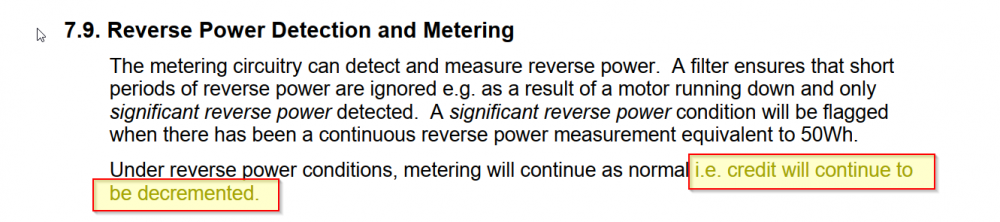

@YellowTapemeasureare you able to export to grid without your prepiad meter from charging you? (ie. extract from the landis+gyr gemini plc2 manual attached, below, link: http://topmeters.co.za/User Guide-1.pdf )
7.9. Reverse Power Detection and Metering
The metering circuitry can detect and measure reverse power. A filter ensures that short
periods of reverse power are ignored e.g. as a result of a motor running down and only
significant reverse power detected. A significant reverse power condition will be flagged
when there has been a continuous reverse power measurement equivalent to 50Wh.
Under reverse power conditions, metering will continue as normal i.e. credit will continue to
be decremented.
I haven't ever exported to grid because I am led to believe that it will decrement my credit accordingly (and as your reference to the manual shows).
