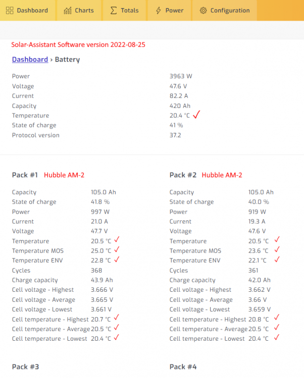

On 2022/08/25 at 10:17 AM, system32 said:
Good News,
Solar-Assistant Software version 2022-08-25 has fixed the incorrect temperature reporting issue on Hubble AM-2 - connected via RS232/console port:
https://solar-assistant.io/help/updates/changelog
2022-08-25Beta
New features:
  • Add WiFi country code selection to network configuration.
  • Upgrade of underlying frameworks and libraries.
  • Basic support for EASUN SMG II and PowMr inverters that use with RS232 WiFi dongle and SmartESS app. Select inverter type "Sumry".
  • Support for most important setting of Must and SRNE inverters.
  • Support for adjusting more Deye and Voltronic settings via MQTT.
Corrections:
  • Correct temperature reading of USB serial protocol.
Interesting, I had also previously had a chat to them stating they were reading environmental temp versus actual battery and after seeing your post, I updated however received a different date:
and now seeing a completely negative temp value - thus from the 29deg to -79deg.
Waiting for the system to prompt me with new update available, see yours is later.

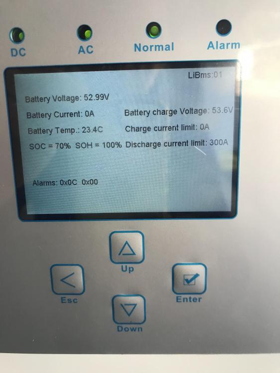

AFAIK,
This is the battery BMS telling the Inverter it is full (0A charge allowed), but the battery is only at 70% SoC.
Check the battery ID's and inter battery cabling.

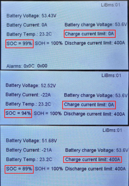

On my system (4 x AM2), "Charge Current Limit" SoC starts at 400A and goes to 0A as the SoC rises to 100%.
I'll take some photos at different times to confirm.
EDIT:
The pictures below show the LiBms as the bank discharges.
Discharge
Between 100% - 95% the BMS does not allow re-charging to prevent continuous topping up.
Charging
When charging, the Charge Current Limit is reduced as the SoC approaches 100%.
I'll see if I can take some images of the charge phase.

Did you follow the procedure which @YellowTapemeasure provided from the Hubble helpdesk?
So when the charge limit is at 0A and the battery is at 70%, there's a 0x0C alarm code. Can you check if the alarm light is flashing on one of the batteries?
I had a similar issue with my 2 batteries where it would only charge to 96% and then the bms would set a 0A charge limit. I've hooked up a riot and saw that one of the batteries had a cell high voltage fault which would trigger this state. I cycled the batteries using the AGM V mode and then left the riot for a day to do some balancing voodoo and it seems to have worked for me, I now get to 100% soc at 54v.

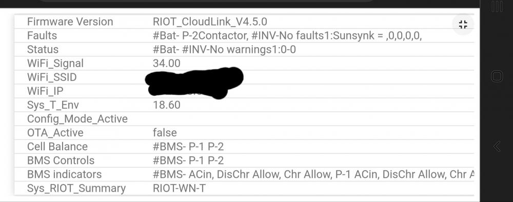

I do get a random contactor fault that comes and goes on one of the batteries, anybody know anything about this?

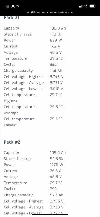

On 2022/03/23 at 11:55 AM, Mier said:
Interestingly, I installed a new AM-2 this morning the Capacity showed 100AH, the SoC was ~50% (shipping voltage I suppose).
It proceeded to charge up to 103.4% SoC. Now, after about an hour, the Capacity is shown as 103.4 AH and SoC is 100%.
I bought one battery in Dec21 and another in Sept22 and now with software have established that my 2 batteries have different firmware resulting in absolute weird readings as below:
                                         Bat1   Bat2
Capacity.                        29Ah     100ah
SOC.                                4.2%.     62.1%
Charge capacity.           1.2Ah.    62.1Ah
Cycles.                            561.         88
Looks like the different firmware could be the issue?
